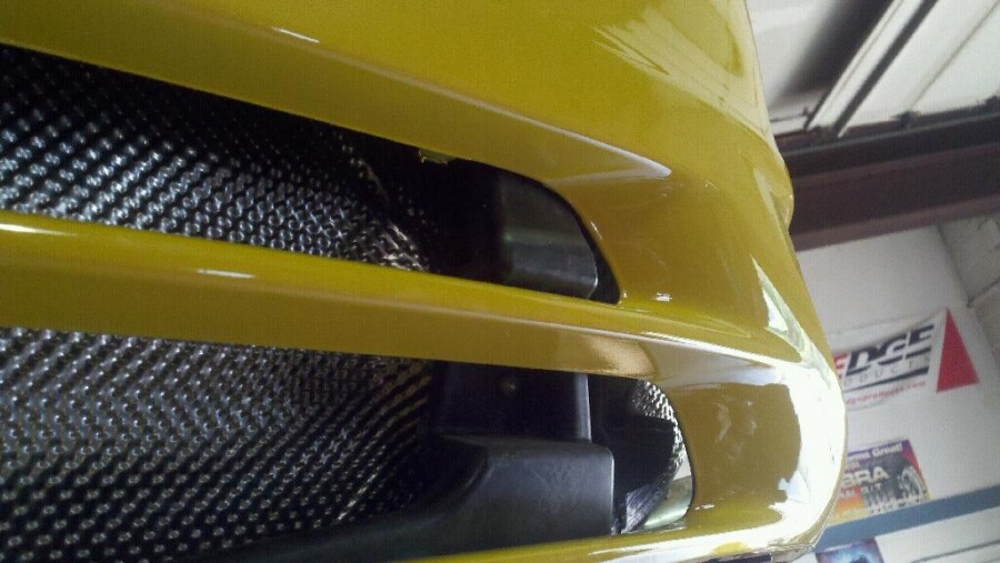

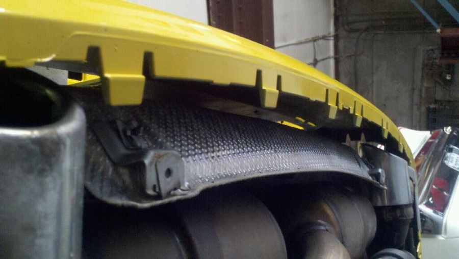

Can these black pieces on the sides be removed or do I need to buy Turbo heat shields? In addition , What do you attach the back part of the bumper too bc it doesn't appear to have anything to mount to? I haven't started the project yet but I'm basing it off of these pictures. I'm probably going to give it a shot on Monday, so trying to get as much help as I can....
