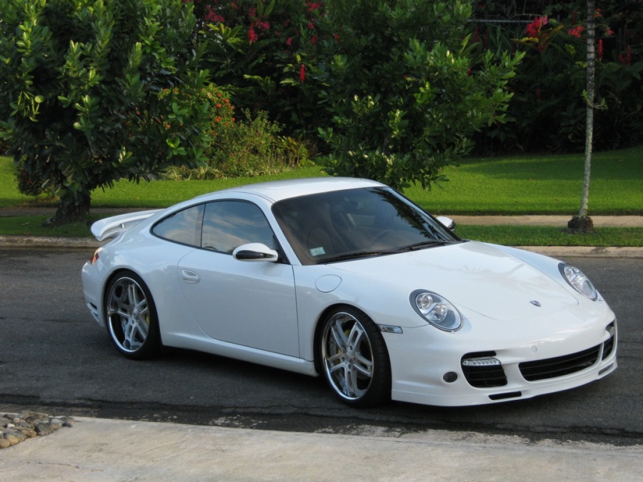

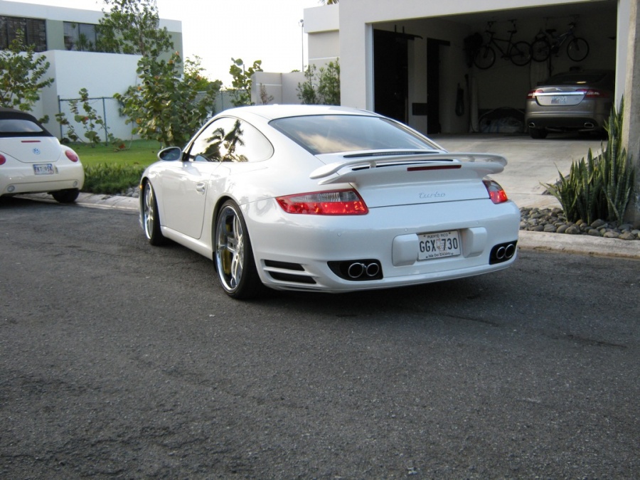

I did the rear 997tt to 997 2005 in my car by myself.it fits with very little mods to the base around the tailight.(only the screw holes have to move a little). The muffler mod is a mayor
pain because you have to remove the bumper so many times to
correct the alignment of the tips. The hole job took like 3 days . If also did the front bumper but this one takes 15 minutes. Good luck

Photos
Here are some photos of the car.
