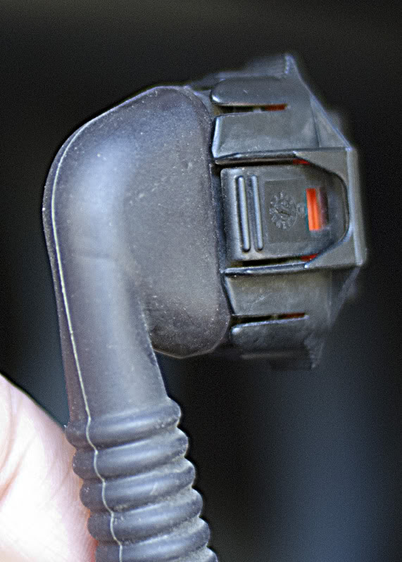

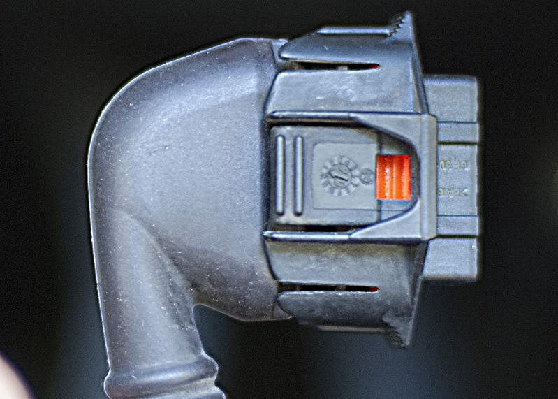

I agree great write up but I had a very hard problem taking that MAF sensor off. After an hour of trying to press hard and pull as the instructions said I just could not get that MAF to unclip. After some profanities and sore fingers I gave up. Since at the end you wiggle the box out after taking off the other 3 or 4 connections, I just wanted to see how much room I had without disconnecting all the other hose/connections. To my surprise I was able to tilt it and access all 8 torxs bits! Replaced filter and I am one happy man! Just wanted to share!

The MAF is hard. Once you find the right area to squeeze it's a snap. It's right at the edge of the rubber boot on the back side. You can actually slide the boot off and then squeeze right there at the edge. It made a click when I did it. Once it clicked pulling it off was easy.
I can take a picture tomorrow if you're still having trouble. I don't think it is wise to strain the cables trying to change the filter while the air box is in the engine bay.

Here's what the back side of the MAF looks like:
Push real hard where those two vertical lines are and it should release.

Ah yes! I was finally able to figure it out with the more detailed picture! Thanks! I did a quick disconnect then reconnect. Looks like I'll be doing my next air filter change in 4 years since I will drive it 5K miles a year.

Tackled this yesterday w/o issue beyond getting that $#@!!&! MAF connector off. Took me longer to get that off than all the remainder of the job. Thanks for the great instructions!
