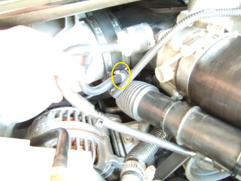

Here is a pic...sorry for the bad pic.
The throttle body adapter to a T-fitting.One part of the tee goes to bypass valve and the other part goes down to the top of the motor and this one has a check valve(underneath the throttle body).
I removed the bypass vacuum line and could push air through...both in and out!
Shouldn't the check valve go between the t-fitting and the bypass valve?
Click on pic to enlarge
Hard to see the lines. Do you have a check valve on any of them? If you want to determine quickly if its the vacuum lines, disconnect the line to the bypass valve, plug vacuum line and go out and let her rip. You'll know if the valve was open.
You can test the valve too. Without vacuum, the should be no flow.
Here is the same pic only I circled the check valve
If that check valve is on the line going to the bypass.....that's your problem. Or is it for the EGR kine?
