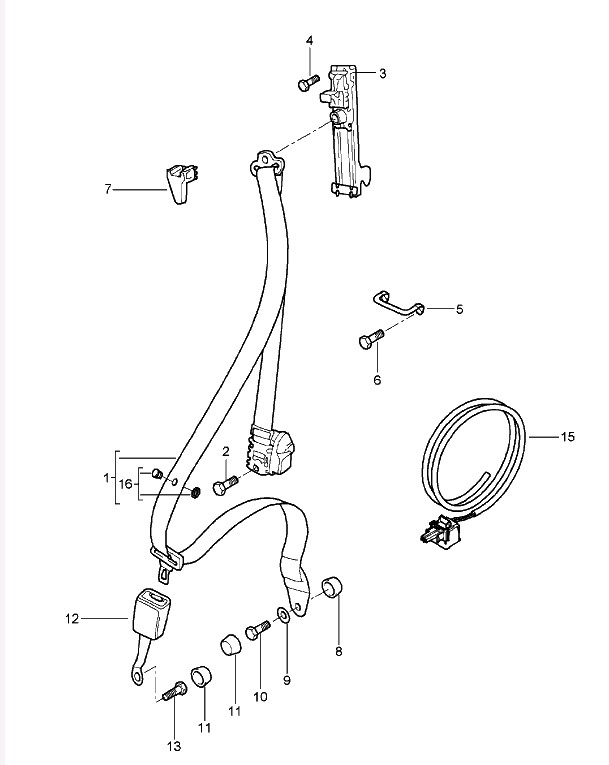

these may also help:

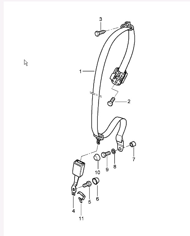

torque for all the 17mm bolts is 37 ft/lb - the two 10mm bolts (each side) that guide the front belt are 10 ft/lb
actually did mine yesterday - got hold of a workshop manual (seek out PorscheLibrarian on Renntech) and it helped me immensely - it instructs to remove both the B and C pillar trim to ease access to the relevant bits on the rears
all up would guesstimate 4 hrs - the second side taking under 90 minutes (you are an expert now)
again, thanks for the post and the pics - they both inspired me and gave the necessary courage to give it a go

attached are the relevant files from the workshop manual - hope they help someone too
