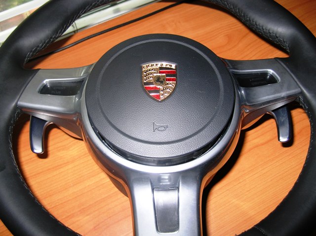

doing mine in couple weeks...I hope
Sweet looking wheel, Did you get that and just the new steering module? What year and type, and where do you plan on getting it done?
