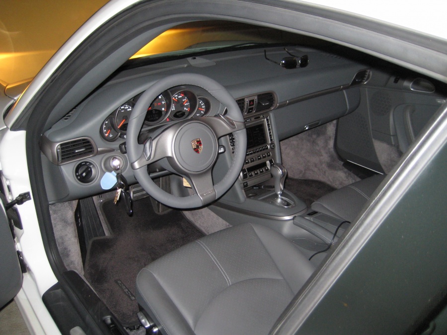

Hey guys I thought this might interest some of the tiptronic owners out there... I got my hands on a 997.2 pdk sport steering wheel and had a lot of people tell me that it wouldnt fit on the hub or the tiptronic shifter on the wheel would be incompatible with the car or I would get an error light. Well... i just completed the install today, everything fully functional (one of my favorite upgrades Ive done so far). Here is a pic of the steering wheel. If anyone interested in the upgrade or need any help just pm me.

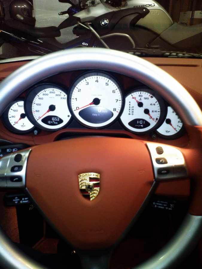

I am interesting too !!Tell me the problems that you had to now if i can do it here in Greece to my 4s tip 08 model.The airbag is the same the buttons work well?The cost?This is mine now aluminum-terracotta.

Thanks guys.....by far my most gratifying mod, and believe me i've done alot of mods so far. Ok heres the deal no adapters, pdk shift works great just like the tiptronic. I did the install myself. If any of you are local id be more than happy to help. The only weird thing is that I posted this more than a month ago. I dont know how it ended back upas a new thread. I guess mod revived the thread. Well thanks for all the props and ill have pics for u guys soon.

I had the triangle airbag so I had to buy a circle airbag which I believe is the same circle airbag that comes with the sport steering wheel.

Hey guys thanks for all the kind words....I gotta tell u though it does feel good to potentially be the only pdriver in the world to have a 997.1 with a pdk steering wheel. Anyway here are pics as promised.
