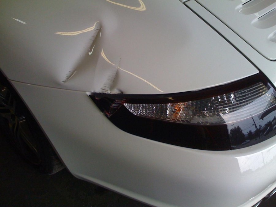

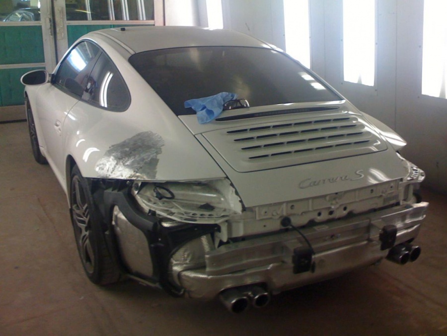

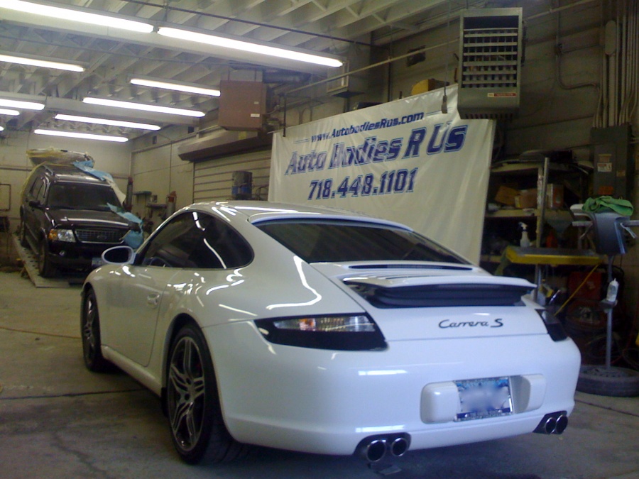

I own a body shop and painted my porsche after some vandalism. take a look at the before and after. The job came out perfect. It seems you went to the wrong bodyshop. Also ask Larry (yrralis1), he is in FL and he is a perfectionist
Wow, was that a crowbar?
Brick
