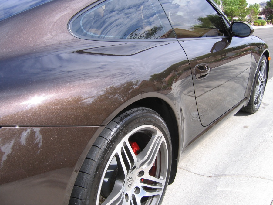

After two years of very carefully parking my '08 C2S, someone finally "door-dinged" it on the right rear fender (I believe on purpose!). I've had both Dent Pro and Dent Dr. look at it. Both guys said they couldn't get the ding out because of the location, and the ridge around the fender. The P-dealer recommended a "high-end" body shop whose estimate was $900. Actually, what bothers me is what the estimator at the body shop said they would have to do to the car: remove the entire rear bumper assembly, take out the rear and right windows, mouldings, right stone guard, etc. And keep the car for a week. $900 aside, I just can't bring myself to allow my car to be taken apart like that. It just doesn't seem right to me (although the dent bothers me greatly). I would have thought that an experienced bodyman could simply "putty" the dent, and feather in a little paint? I'm trying to decide what to do (just live with it?), and would appreciate any advice, suggestions, comments (and empathy!) I've attached photos. Thanks!!!

I got a ding in the SAME EXACT SPOT!
Yes your body shop is right, the would have to remove all that just to do the ding. My body shop (which I trust and is the best) told me the exact same thing.
A GOOD ding guy can make it look 90-99% gone!
I have a great gut that did another one for me on the front dender that was worse than that and got it 99.9% off.
He's in San Diego and charged me $200

Sorry to hear this man. If you get into paint work, the process you stated is the only way to do it 100% correctly. If they don't take out the windows, moldings, etc., there will be a line where they masked these sections off and you'll be able to see where the new paint meets the old paint.
I would also advise trying to find another PDR shop. Some of those guys can work miracles.

I had matching ones on both of my flared fenders on my E46 M3. Classic ding from the rear door of an SUV when a kid gets out an nails your car. Miraculously, a dent removal guy got one out, but didn't get out the other. Only paid $300 for those and several more. I would note that I took the car to an indi shop and ther "dent guy" couldn't get any of them out. Went to the ding guy at the BMW dealer (someone who worked independently on cars that came in for service) and he took them all out. I also got dings above the wheelwell on the fender - seemed like a really bad spot. Guy took them out. Highly recommend shopping around. The paintless dent removal is an art and some people that do it are artists, others aren't. I feel your pain.

That area is really hard for paintless repair because the ding forms in a v shape with right angles which don't pull out easily...a "dimple" ding pops out if done right by a skilled tech.

Wow that is quite the ding! That is a very strong spot - right angle and seamed vs a body panel open area.
Same thing happened on my E60 M5, caught on of my employees on surveillance tape after I came out and noticed it at the end of the day.
Mine was about $900 and same deal....had to take apart the panels ect to fix it.

The hardest spot to fix a dent is the roof of a Lamborgini . My repair guy told me he spend two days on a car to get it right . That V shaped ding on the fender would take him 15 minutes at most. Miami is 3K miles away but you can always combine some modding, a beach vacation, and a ding repair into one big summer road trip.

I got one on my old M3 in the same spot too. There is a double layer of metal there such that a paintless dent repair usually cannot be done there. This is literally THE worst place to get one on a car.
