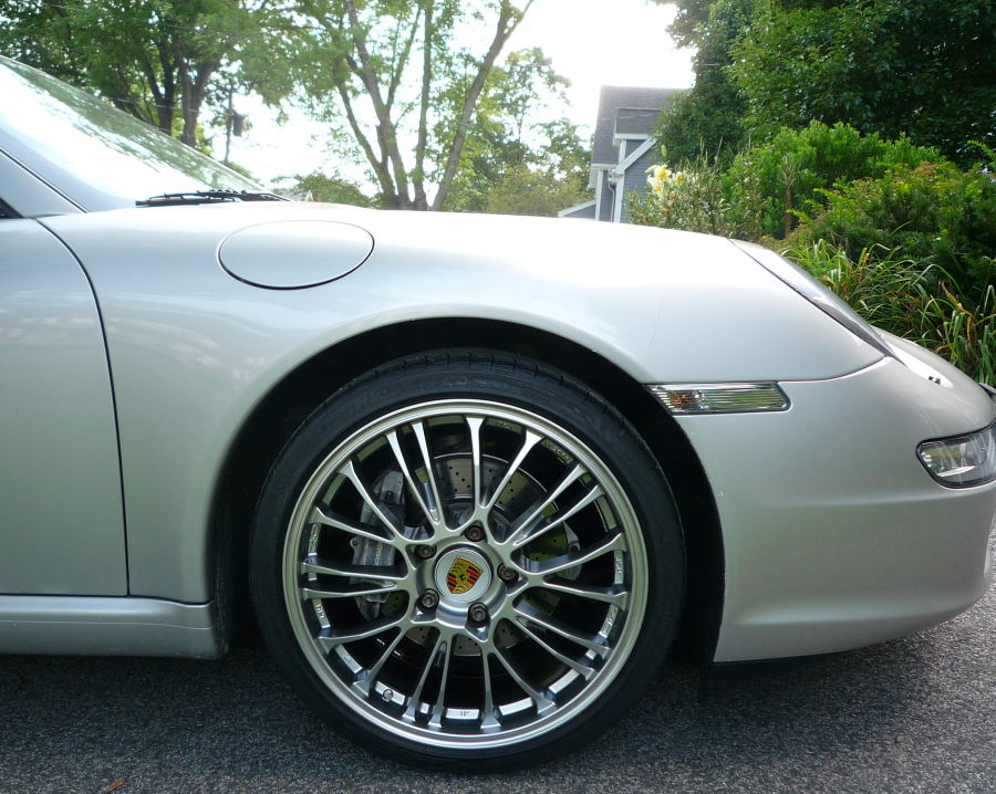

I just got botticelli`s and I think they look perfect - matte titanium finish, nice style, to my taste they do look better than ultraleggera`s. But heavier, of course.

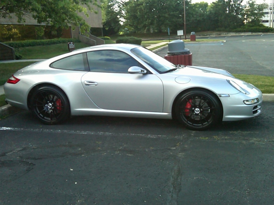

Hey there. I sent you a PM, and here are a couple pics of my car with the 19x11 rear OZ Ultraleggera's in Black, with the 65 offset! Of course, because of the black wheel it's hard to see the concave (haha!) but trust me, they look good
Ohan

Those look GREAT against the red brakes. Well done.
