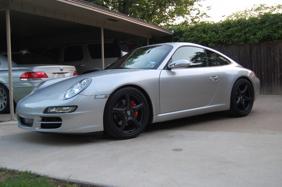

Here is mine - flat black ----they were blasted first and painted by a wheel specialist
I was thinking about that for mine -looks cool on Arctic. How much did that run you?
I had it done at RUF auto in Dallas for 150.00 a wheel - that included rebalance and mounting.
Originally Posted by Boober
Looks very nice! What suspension work have you done?
Thanks Boober - I have H& R springs. It sits right at the GT3 height.
