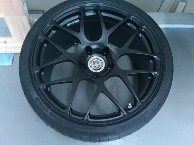

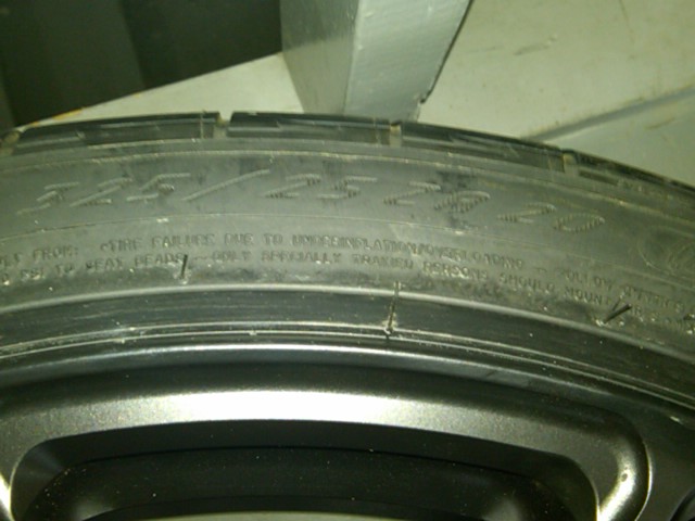

Sorry to thread jack but here is the P40 with 325/25/20 PS2's

Those are 26.3" tall...much better. Those would be nice on a wide body PCar with 12" wide wheels.
