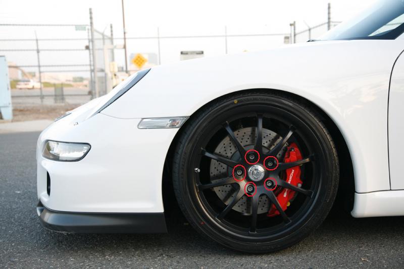

I was seriously considering getting those wheels. There are 2 problems:
1- For some reason I have heard that a lot of people had problems with iForged... There were couple of threads on the forum that the wheels were making noises and shaking... I talked to Dan from Vividracing and my dealership, they both said that it was poor quality.
2- If you really carefully check the pictures of the TE14 on the GT3 you will see that the holes are really close to the edge of the center... I don't know if it would be safe... I am attaching a picture for you to see what I mean.
