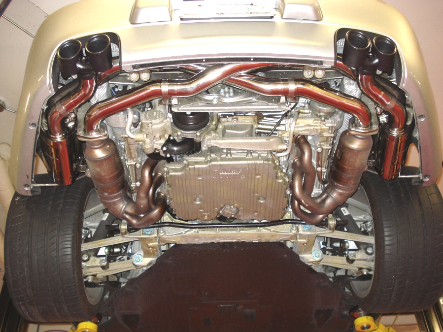

BTW -they sent me a pic of one they did on a 997.2 . The exhaust looks amazing .
