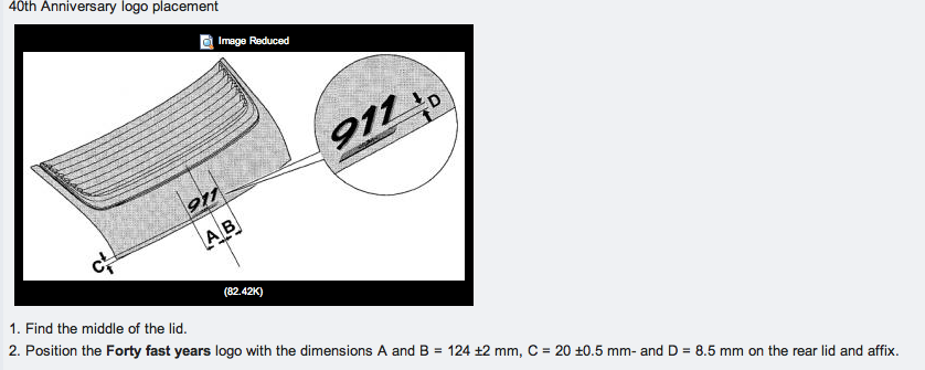

Purchased the 993 "911" badge. Does any one have teh instructions on mounting locations to match up with factory. How many inches up from bottom of the decklid? Any suggestions; thanks.

Here are a few from Renntech
The 40th Anniversary one has an extra measurement for the 40th Anniversary badge.

many thanks. exactly what i needed

Good luck, I had to put one on my first 997, it is a little challenging due to the curvature of the deck lid. Use painters tape to mark the position and a level to make sure it was not skewed.
Just be patient and double check all your measurements.

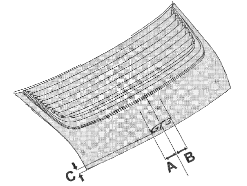

I have a 05 997S with aerokit and would like to reference the emblem location to the mounting diagram for 997 GT3. Where can I find emblem placement instructions for 997 GT3 on Renntech?
Please help

I sent this PM to you, and then saw this post, incase anyone else wants it.
This is from Renntech.org for a 996
1. Find the middle of the lid.
2. Position the GT3 logo with the dimensions A and B = 78.2 mm- and -C = 28 ± 1 mm on the rear lid and affix.
http://www.renntech.org/forums/index...adge+placement
