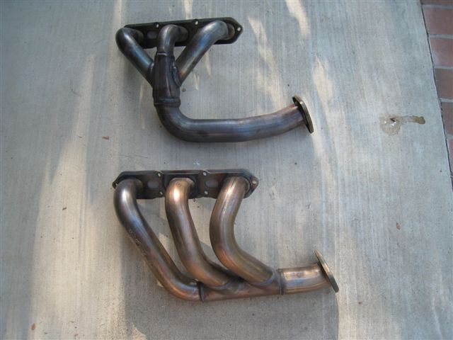

Found a pic of stock 'S' headers vs. 'X51' headers...adding X51 to the mod list

Originally Posted by ntlgnt1
I've been told by reputable sources that the stock headers are pretty good. Replacing them will increase noise and give small small gains, not worth it IMO (unless you're tracking it). The real gains come from the cats and this looks like a nice setup. Can't wait to hear the clip.
Actually the design of the Stock Headers are terrible... They are really restrictive. The X51 headers on the other hand are much less restrictive. They are much cheaper than other Aftermarket Headers and provide pretty much the same HP. I have it on my car and did not change the sound much but I can feel that they are less restrictive from the throttle response
Here's a picture I found of the stock headers from Sharkwerks:
I agree, my original post was information I had received about 3.6L stock headers not the 3.8L. Didn't mean to cause confusion.

Here is a better and obvious huge differences pic of the headers:
