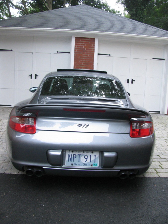

Try it with the stock wing blade for starters, you may like it. The 997TT wing blade comes off the turbo which is a wide body, so it actually looks a bit bigger on a none wide body car.
Need to either cut the stock air box for hydraulic arms to fit inside your engine bay (could mess with MA flow sensor) or simply replace stock airbox for one that takes up less space like a K/N or Evoms. (I did evoms)
Then the wiring..... a bit of a hassle but great installer should be able to handle as you want the second wing blade to work the same way.... raise and lower at 70+mph etc...also note on this rear deck lid of a 997TT there is a brake light in the blade itself so will need to terminate those wires if you swap out for wing blade with no light.
IMO the 997TT wing blade is hands down the nicest wing for the 997 out there.... unless your modding hard and creating a track monster or other IMO a giant carbon wing blade will not look good at all....
Good luck and here are two pics.... many have seen before of my car.

I have to admit I personally did not do the install, I paid my guy... but was kept up to date on things... I will email you pics when your ready to do it. Its not just a simple cut and match, think a bit more involved. I did not buy new harness, my 997tt wing blade came with just cut wires and my installer had to figure things out.
I maybe off on this but here is an instance... on stock 997 when your rear wing deploys the integrated brake lamp in the deployed wing takes over and the fixed light I believe stops working..... that would be silly with the 997TT wing blade cause the brake light on the 997tt wing blade is always in view wether 2nd wing blade had raised or not. So when I brake at night I actually have 4, yes a 4th brake light... actually looks pretty cool.
I will dig up some pics to post maybe next week on this. If you buy the 997TT rear deck lid (which OEM costs over 13K for all needed for this swap) I will try and help by send you some detailed pics.
You'll also need to move the fan over a bit. my guy fabricated a few custom brackets. (not a big deal) I wanted it perfect so we did this, others maybe ok with it not lining up perfect... you will know what I am saying once you get into the project... also for paint... you gotta do it right, and remove the top wing blade completely which is also a major hassle... guess you could tape it off etc, but again I wanted mine to look 100% oem so probably went a bit overboard so one would think this was from the factory.
No better modding (all modders IMO have their own style) then creating a trick looking car, that one would swear could come from the factory the way its seen but truth is tons of mods went into the car for the look achieved. Unique, different, upper end OEM look. My car is a 05 997 (not even a S).

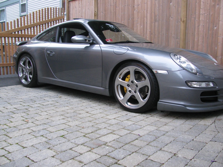

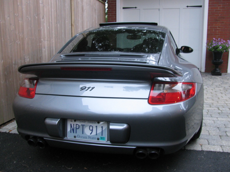

Here are some more pics, hope it helps to explain brake light etc and give a better visiual that you may not need a giant CF wing blade....my brakes are powder coated yellow NOT PCCB... if I had to do it again would have went mexico blue. I did yellow cause I like the look, not trying to pose, thus the note.....if I did the blue wouldn't need this dumb discaimer

I've often wondered how the TT wing would look on a non-TT, and you've shown that it's fantastic.
I am surprised, however, at the extensive amount of work that it took to make this work. I was thinking that this would be a fairly simply plug-play (same size hatch, same up/down speed functionality, etc), but apparently not.

Mick.....I wonder if you could post a picture with the tail UP.....THANKS
