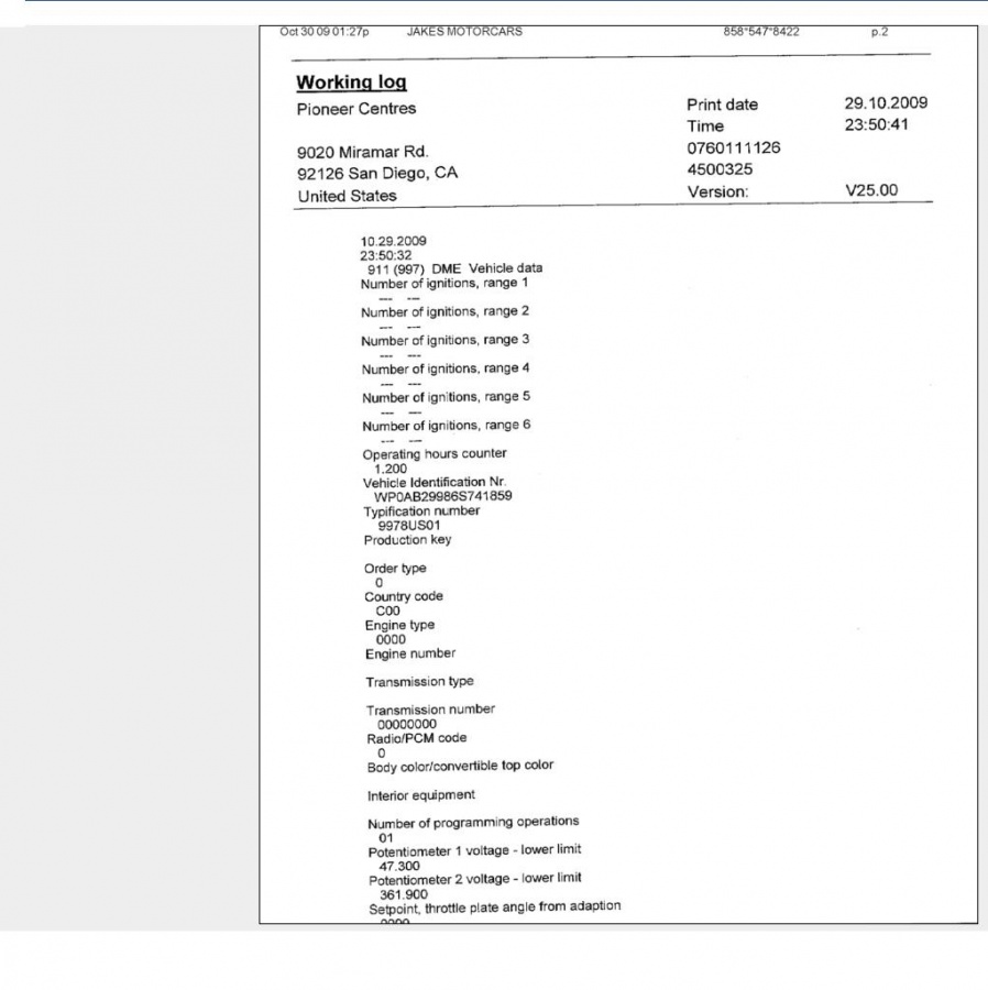

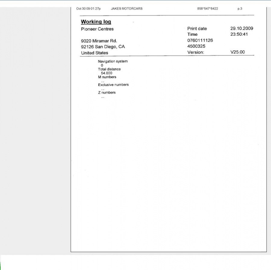

I've had a chance to fiddle with both PIWIS and Durametric...I have never seen an odometer reading on a PIWIS printout of the DME, but it will read the odometer from the cluster. Not sure what the 54 means...wonder if he/she could post a scan of his printout.
bbywu - I am a he
I agree w/Larry; think it can only be one of two options. I'm generally a trusting person, but this one doesn't smell too good. I will give them a chance to come clean, then walk away. I should also contact PCNA.
A Scan of DME attached.

Im thinking a new DME was installed 1.2 operating hours and 54 kilometers ago.

Kyle, I was hoping you would chime in here...why would they do that...if the DME failed why would they not program reasonable engine hours and acutal speedo miles into the new one...this situation makes that car suspect forever

Yes, VIN from scan report matches the VIN on vehicle. Indi said they can do the DME scan again . I told Indi he needs to get with the P-dealer and speak to Service Manager and ask them to explain what happened. As others posted here, give dealer a chance to come clean - honest mistake or other.
As I understand from posts the causes may be:
A) New engine - ECU should have been updated w/actual mileage
B) Flashed ECU - should have been updated w/actual mileage + operating hrs
C) DME scan off another pcar
D) New DME module - should have been updated w/actual mileage + operating hrs
Will get on the phone w/Indi on Monday and work this through. At the moment if will take moving mountains to get me into that car, but I feel obligated to get to the bottom of this so the next potential buyer may not have a bad experience.

1 could be the original DME was bad and replaced and no data could be saved or transferred out of the old DME.
or... 2 the dme was replaced for what ever reason and coded manually for the vehicle.
With the tools available to the dealership they cant alter operating hours or reset overrevs. Data would have to be transferrred out of the old DME and into the new one during programming. When one is replaced, Data is read out of the old module and saved into the system tester, it is then programmed into the new module, If the old DME failed in a way that it isnt possible to do this, then the module is manually programmed for vehicle type,and options as well as the engine map for which ever emmision standards for the country the vehicle is in. But not logged information like operating hours, over revs, mileage. etc....

Thanks, Porsche917. It appears you were spot on. Here is response from Porsche Dealer:
  1. The DME is never replaced when the engine is replaced. The only reason the DME was replaced on this particular vehicle was due to the fact that the unit froze up during a routine service action that requires remapping the DME for a rear engine compartment blower fan operation.
  2. The mileage on the new DME is set to zero from the factory and cannot be changed. The mileage is documented from what the instrument cluster and/or the original DME reading was. However the original DME could not be accessed due to the fact that the unit froze up so actual mileage is document from the instrument cluster. The instrument cluster is set to zero from the factory and cannot be altered once the unit is “burned” or programmed to the vehicle which includes putting in the correct mileage.
  3. The DME from a ‘09/’10 vehicle will not work for this vehicle. That year vehicle has DFI injection where this vehicle does not.
  4. There is no reason to replace a DME when the engine is rebuilt. The only reason a DME is to be replaced is for an electrical issue/software issue. Even then the mileage cannot be altered (they are always set at zero from the factory and start to count the moment the unit is programmed to the vehicle).
  5. I have seen DME’s fail during this process and for other reasons. I understand your concern about tampering and/or inaccurate mileage however everything is documented at the dealership as well as Porsche.
