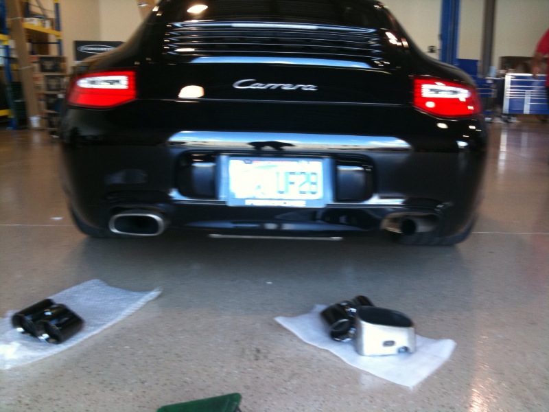

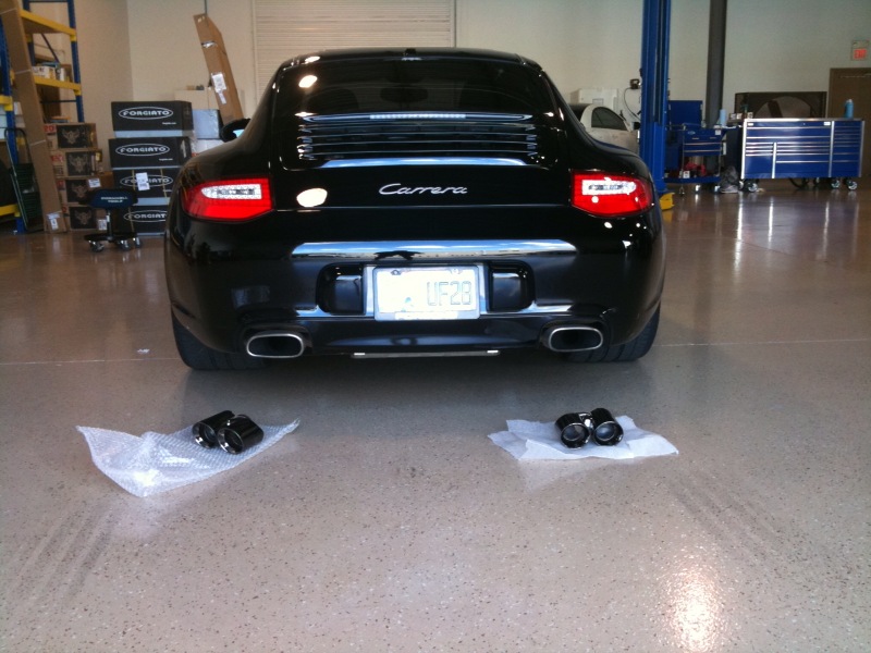

I had Techart black chrome quad tips installed on my 2009 Carrera..took a little modification-sleeve had to be installed to adapt.........
Those look like they stick out too far- to my eye.
Perhaps cut an inch or so off the end of the outlet pipe to the mufflers, unless you can just loosen the clamp and slide the tips back toward the bumper.

I think it is probably from the upward Ngle looking down thY they Appear to stick out. They look great and I'll post a poc from a lower angle.
