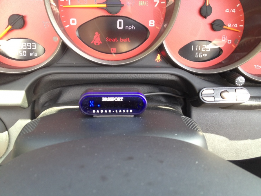

I didn't take pics of the sensors outside of the car yet, but here is the interior install. Display on top of steering column and controls just off to the right (5 buttons under clock). The top was down, so the sun washed out the words on the buttons.

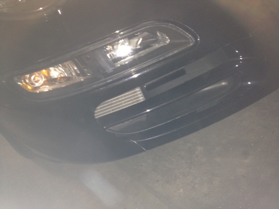

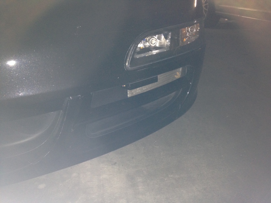

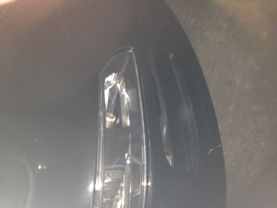

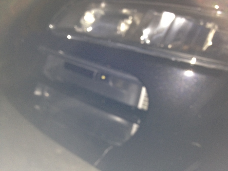

Flash pics up close in garage so not the best quality. You can see the clear bra seams and wax around them! Anyway, as you can see they are black and don't protrude from the car. I think well done by Samm Sound. The rear laser shifter is just screws on the top of the license plate.
You need to get your set up tested. You will get MAJOR punch through with your heads angled out like that. They should be straight with the front of the road.
From your pictures it looks like they could aim center mass and your jammers would never see the signal. Plus they would not be able to send a jamming signal back toward the gun.
