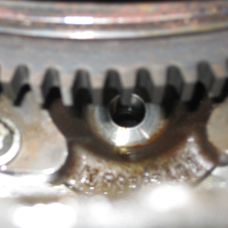

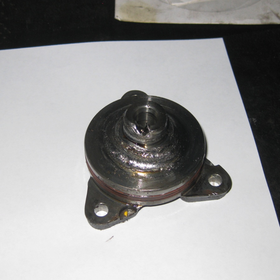

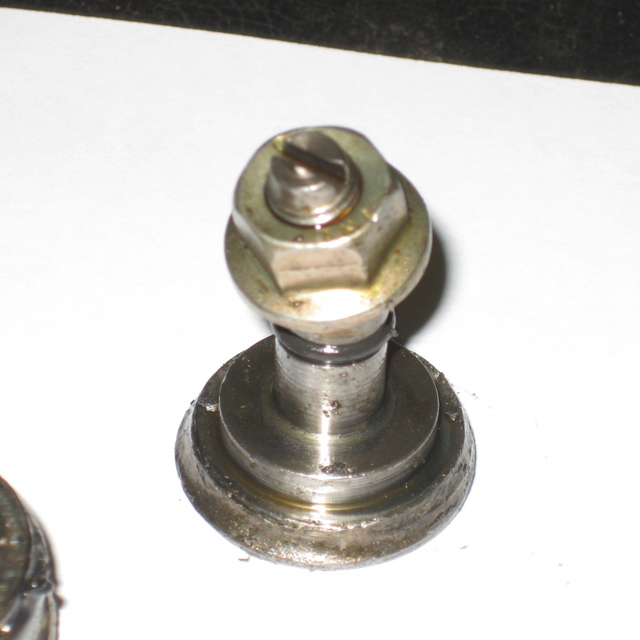

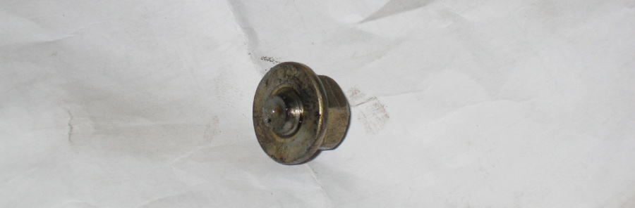

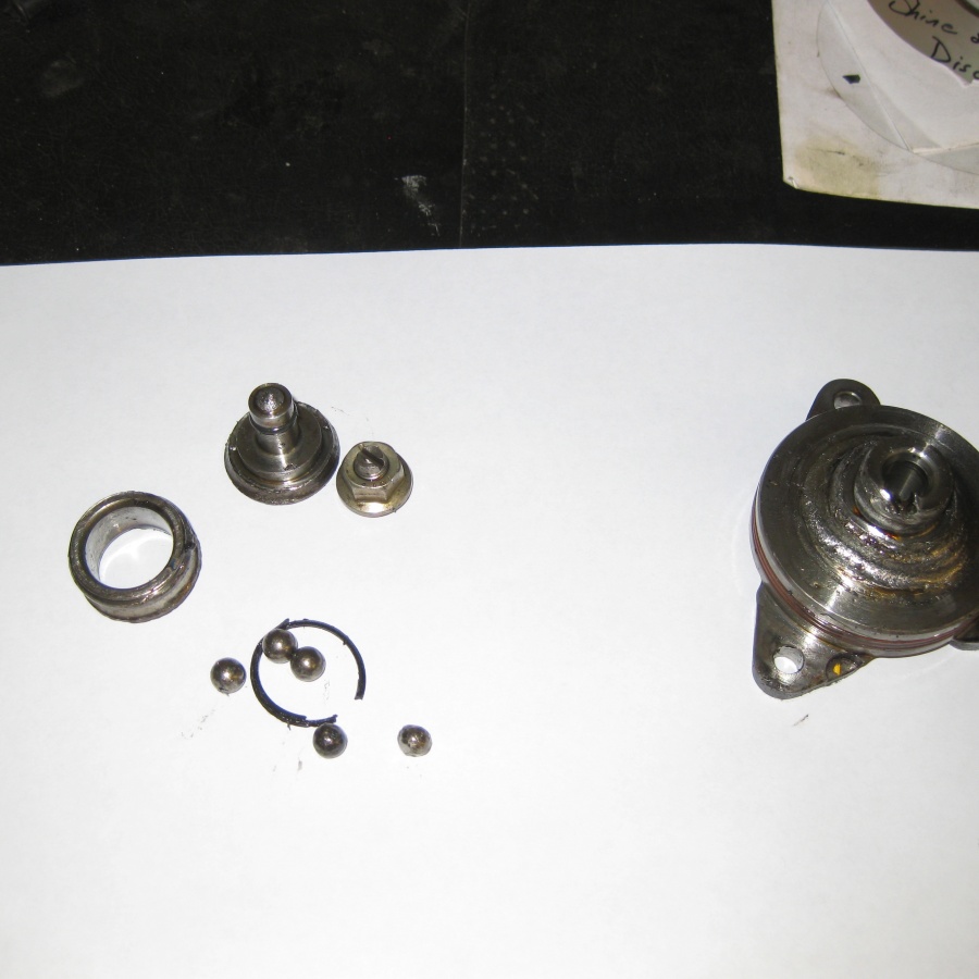

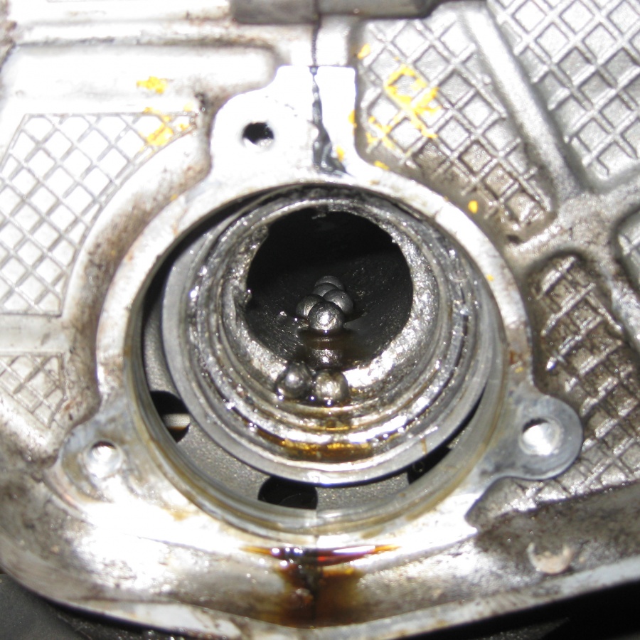

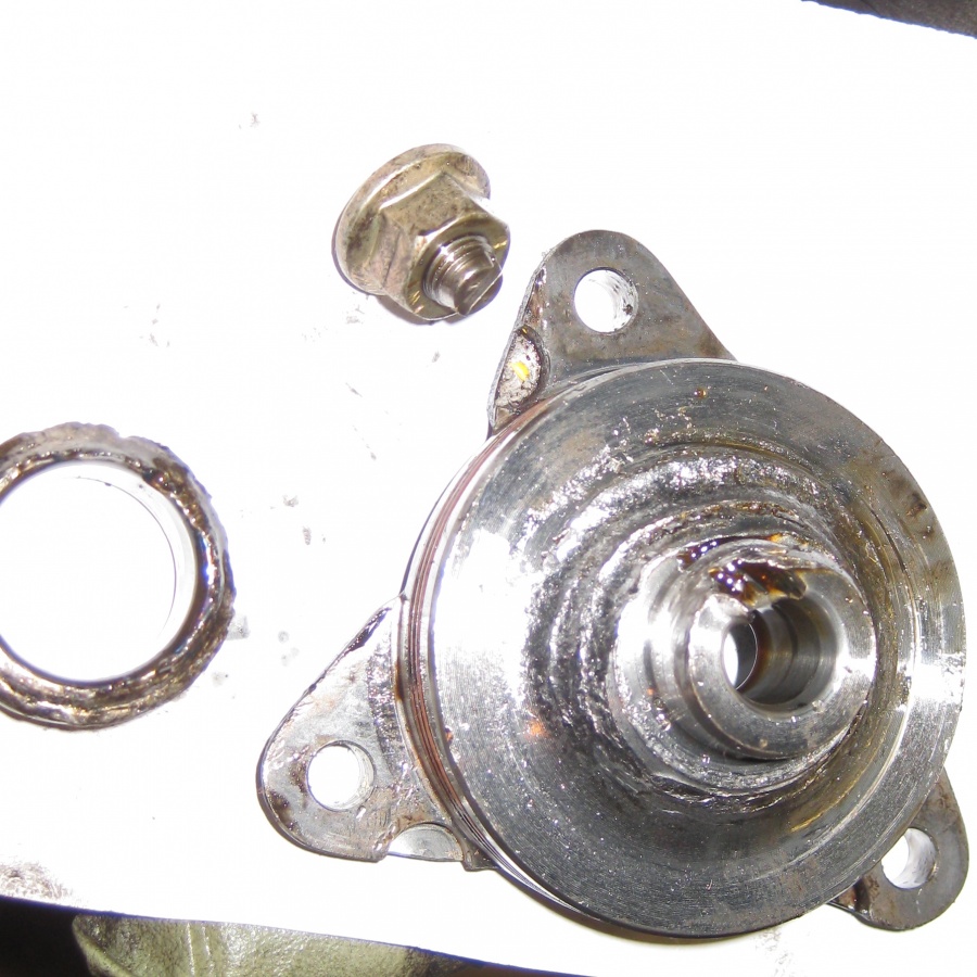

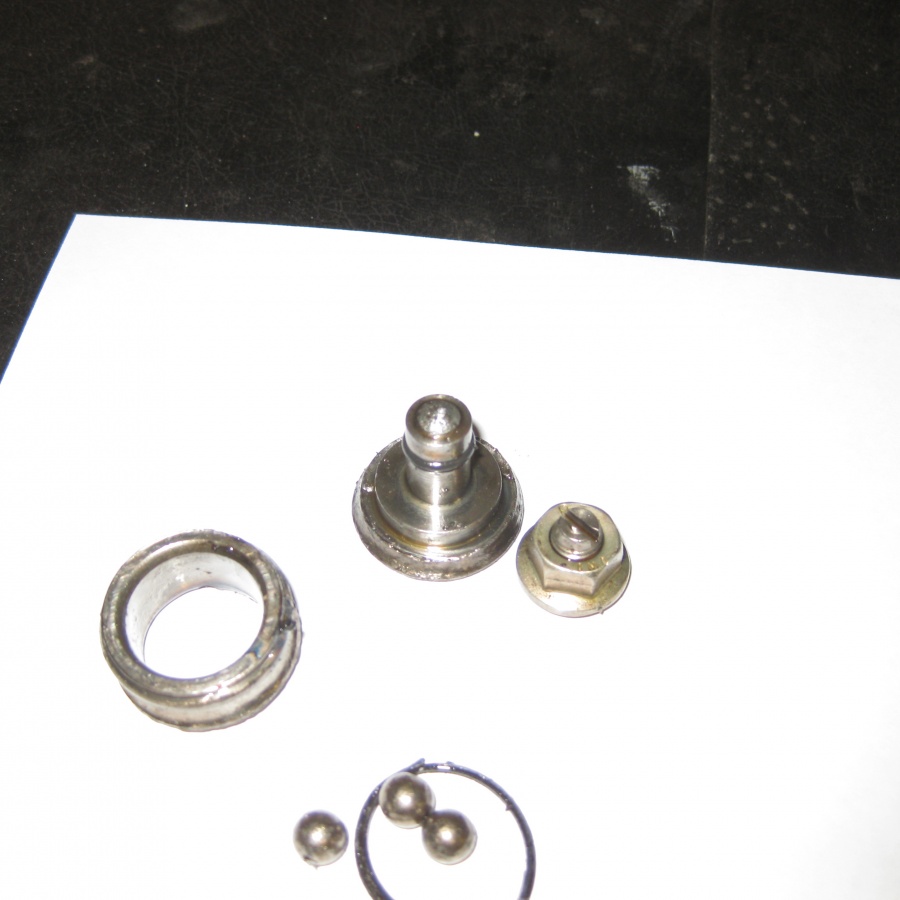

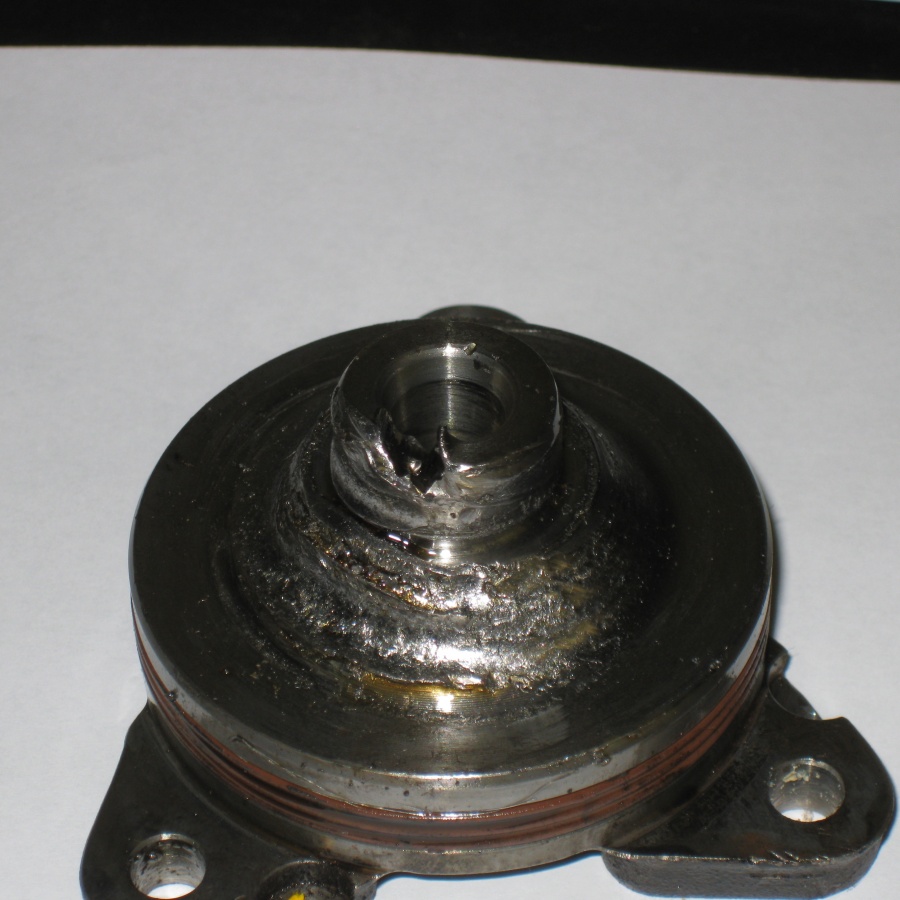

It is the shaft that cracks and then the bears fall out into the engine and all the engine oil pours out. I have pictures of the shaft and where it broke and the bears all eaten up from jumping around the engine, but for some reason I can up load them. The bearing noise sounded like my muffler fell out and I was dragging it. Bad feeling!!!

I would love to see the photos, if you can sort it out. They might be too large to upload, so try to compress them.

Here are the pictures:
Name:  Tony manino 997 009.jpg
Name:  Tony manino 997 005.jpg
Name:  Tony manino 997 007.jpg
Name:  Tony manino 997 003.jpg
Name:  Tony manino 997 008.jpg
Old Jan 1, 2010 | 08:40 PM
Porsche05's Avatar
Joined: Feb 2009
Posts: 179
From: Hoboken NJ
Rep Power: 35
Porsche05 has much to be proud ofPorsche05 has much to be proud ofPorsche05 has much to be proud ofPorsche05 has much to be proud ofPorsche05 has much to be proud ofPorsche05 has much to be proud ofPorsche05 has much to be proud ofPorsche05 has much to be proud of
Here is some more:
Name:  Tony manino 997 016.jpg
Name:  Tony manino 997 015.jpg
Name:  Tony manino 997 013.jpg
Name:  Tony manino 997 011.jpg
