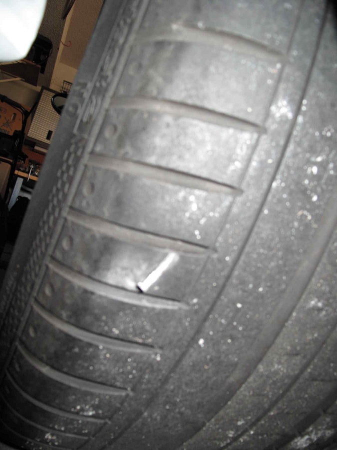

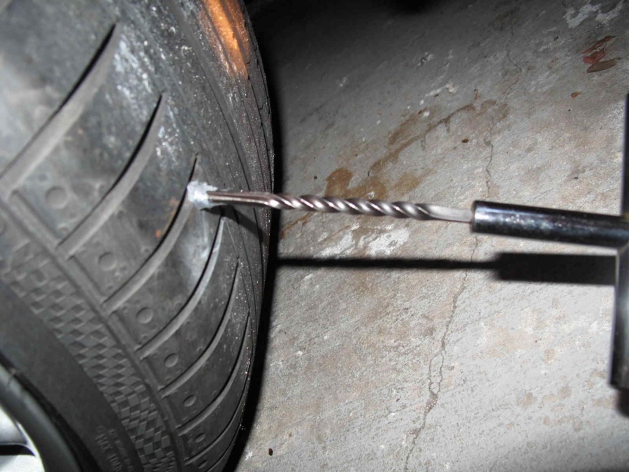

Driving from the house this weekend, I found my lr tire low about 10 pounds. I backed up to the house and discovered a nail in the tire. Hole is small, not close enough to the sidewall. Defiantly plug-able. This post is not about the merits of patching vs plugging vs new tire replacement. This is about easy, hassle free, save your ***, back on the road in ten minutes w/o even jacking up the car.
First things first: I fixed tires in early college years. Get yourself a decent tire plugging kit. I personally over the years have tried the type they sell at the local auto parts stores. They are not worth it. They mostly do not work. And even if you do get a good one, and you have never plugged a tire, find an old tire and plug it (for practice). The kit I bought has four times the plugs that I will ever use. A lot of force needs to be applied to drive the plug into the tire. This is where the cheap kits won't work. You need the heavy tee handle. You will also find that you probably need a few types of pliers to pull the nail out - Maybe even needle nose pliers.
Pic 1 - the kit
Pic 2 - the nail.

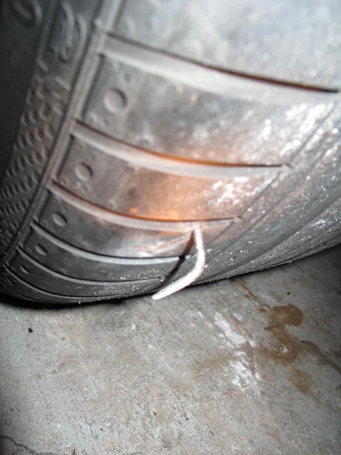

Pic 3 - make note of the direction that the nail went in. You need to plug in same direction.

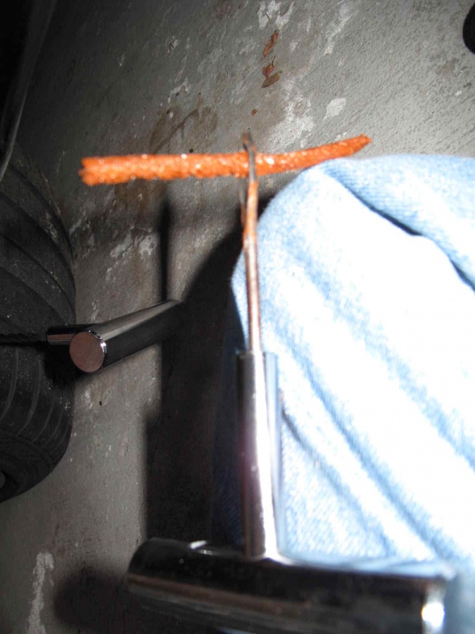

Pic 5 - the plug
I also carry a spare tire and jack in the trunk in case the plugging will not work. This whole process took 15 minutes including the time it took to get the camera and take photos.
I personally know that this repair is good enough to drive many miles - if I drive the speed limits. I have bought myself the time and convenience to decide what my permanent repair option choice will be.
