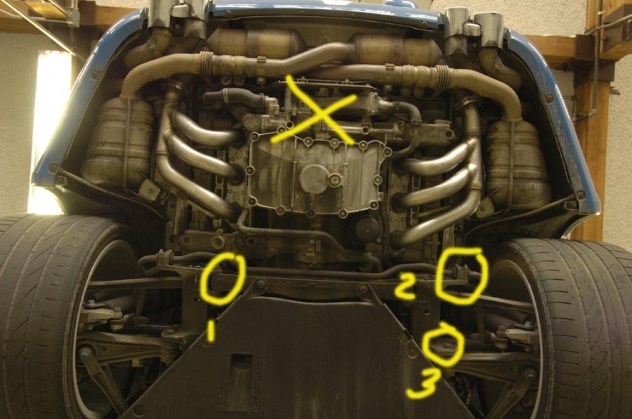

If you have a 997.1 this pic shows points where you can jack and then put the stand at the jack point or raise it at the jack point and put a stand as shown.

You can jack the tab right behind the oil pan as indicated by "X" in vexed's picture. Rather than using cross member (which is fine), I would use the jack pads located right front of the rear wheels for placing the car on jack stands.

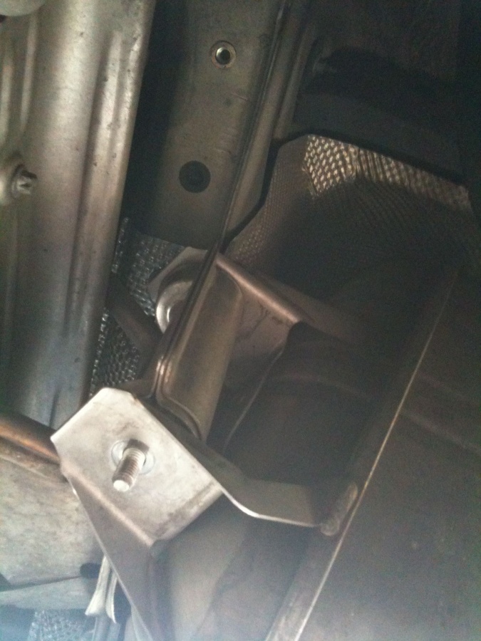

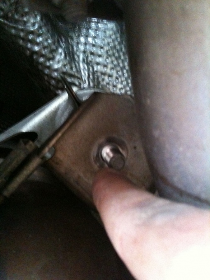

Got the car up, (thanks guys) but now the bolts holding the mufflers don't have enough room above them to slide them out. There's some silver shielding about 3/4" above each screw that can't be moved. How the heck do you pull these bolts out to slide the mufflers out?!?!?!?
Old Jan 16, 2010 | 01:30 PM
machina's Avatar
Joined: Oct 2008
Posts: 296
From: USA
Rep Power: 30
machina has a spectacular aura aboutmachina has a spectacular aura about
you have to remove the 3 bolts that hold the mounting plate to the car first.
you cant get those long bolts out as you have found out.
you have to undo 3 those horizontal bolts/nuts that keep this plate in place in which you have those vertical bolts mounted. It is quite difficult to reach but quite doable.
when you`ll get plate off do not forget to reverse this bolt 180 degrees so it could be easier next time.
