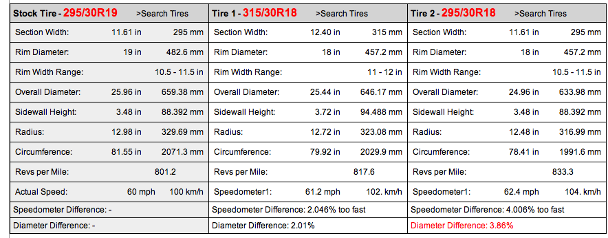

Aspect is the side wall.
http://www.tirerack.com/tires/tirete....jsp?techid=46
The OEM 295/30/19 vs a 295/30/18 is too short. I run a 315/30/18 and it is still a little shorter but is close enough.
