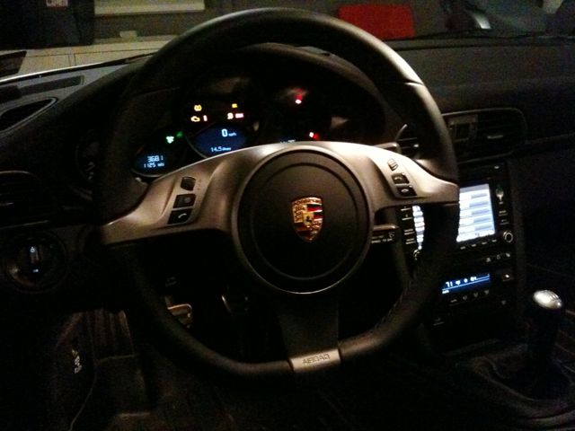

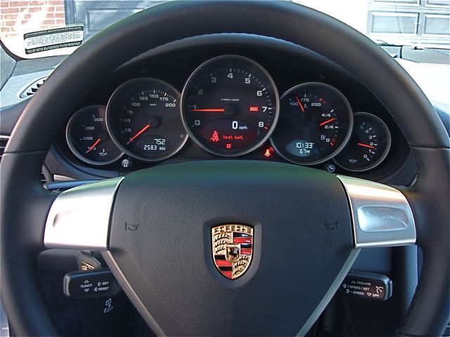

Before and After Pics...
Here's my stock wheel vs. the new wheel:

Looks great - your perseverance paid off.
