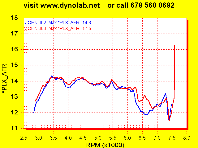

Cattman: Before you do any further tuning, get an accurate a/f ratio reading. You are nowhere near 14.3:1 at WOT.
Here's my AFR chart, attached.
