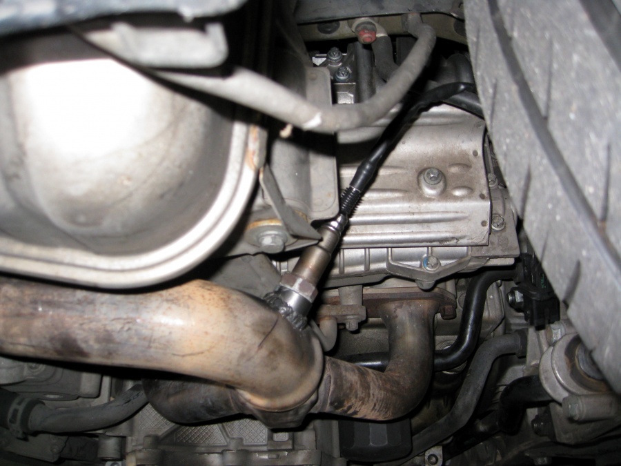

With the modified VF-E SC on my 3.8L 997S, I wanted to run it on a dyno, just to see what it said, and also to use their AFR. Headed over to see Arthur and Dave at Dynolab in Marietta- great guys.
They welded a bung for an 02 sensor into the passenger-side header, and fitted their sensor into it. I plan to use this bung for a full-time AFR sensor that I'll install at a later date as a digital multi-gauge (AFR, Boost, EGT) located where the sport chrono eye would be. I don't have sport chrono, so we'll be creative and buy either an OEM leather or aftermarket carbon housing, drill a hole for the wire into the dash, etc. It'll look totally factory. Then they hooked up a boost gauge, right at my throttle body.
We did runs in 4th gear to redline, and nailed 442 RWHP, 323 max torque, at max 6.1 psi boost right at the rev limiter. Boost increases right inline with RPM- very nice! All runs were the same, it was very consistent. Here's a video, and a pic of my car on the dyno, as well as the dyno sheet itself. Dynolab is sending me the full data, as I was running a bit lean at 14.3 AFR, but since timing is not being altered I am safe. Still, I wouldn't mind running with a bit richer mixture.
While I didn't need this data to tell me the car is blazing fast, it sure doesn't hurt. Depending on what % drivetrain loss you use, I am anywhere from 510-530 HP at crank.
