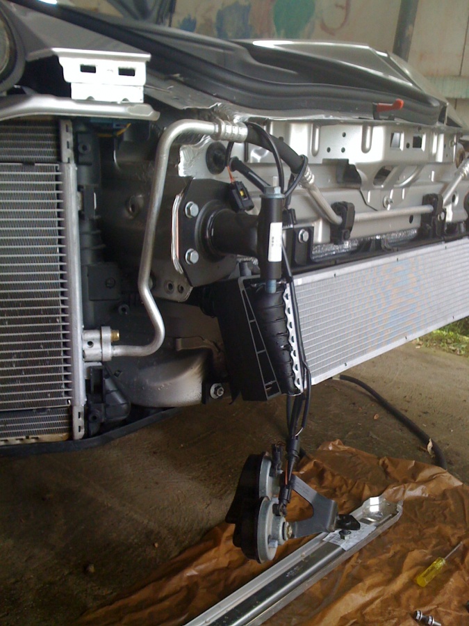

997.1's dont have a center radiator standard. Tiptronics have a centre transmission radiator, manuals have a "blank' in the front bar. the 3rd radiator kit can be installed afterwards or come as part of the X51 power pack. As "verde" says, it's not a difficult DIY. I got mine from Suncoast...
