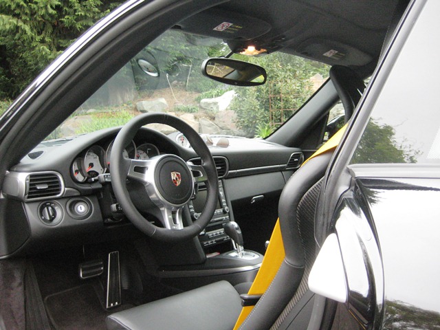

i just put it on my 2009 PDK. absolutely love it. no knock on the old wheel but i like the looks of the new wheel better.
FYI, the sport chrono indicators on the one version of the paddle wheel are not currently compatible with 2009s if you retrofit it because of a DME problem. i'm hopeful we can figure out how to make them work together but i'm not sweating it.

brendo, thanks so much for the info...excited the retrofit works. Your car (especially with that steering wheel) looks amazing, appreciate the pics. Agree that having the indicators working would just be bonus.
Hope the labor costs weren't too over the top, but regardless this is a nice upgrade to the original PDKs.

labor costs are about 1/2 hr it's easy - and i like the look and fuction much better. for the record, i was really fine with the toggles but this struck my fancy and i think will suit my needs better at 7/10's + driving at the track.
