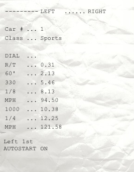

+1
see attached file, its from an iphone app

Originally Posted by Alnoaimi
+1
what mods are you running? 12.25 in the 1/4 and that trap speed is realy fast even for a c2s.
