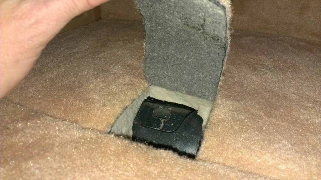

Finally, exposed the tether:

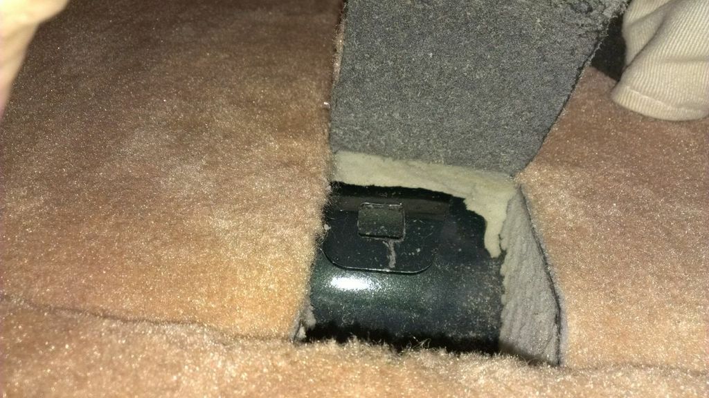

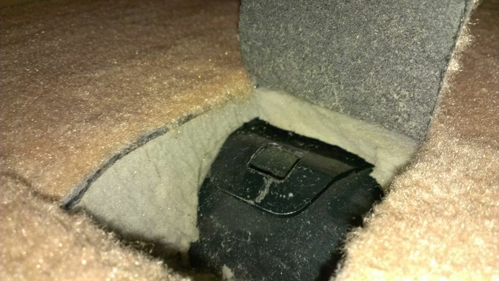

Apologies to those that hate seeing old threads brought back to life, but I was looking up some of the car seat thread I read while trying to answer another more recent car seat question and realized that the pics I thought I linked, aren't here. So I re-took them.
Hope these help someone and provide a good idea of how deep these restraints are buried (2009 997.2). I love how these are exposed on the new 991.:
