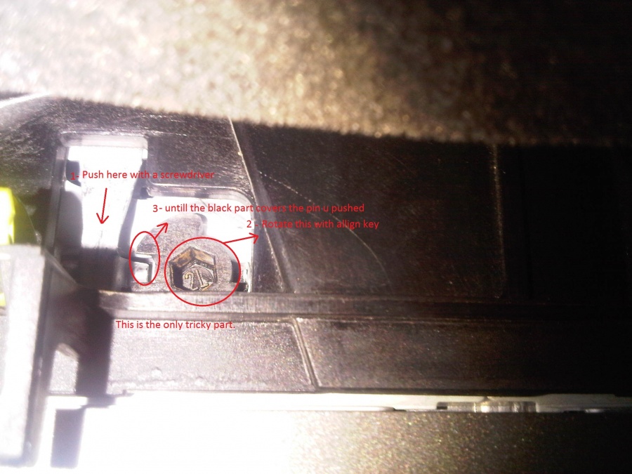

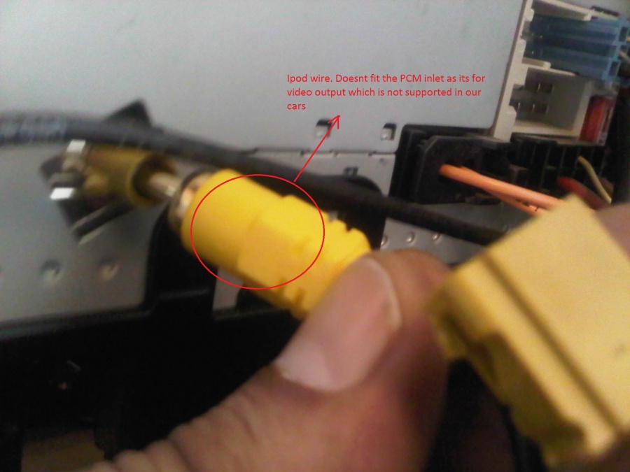

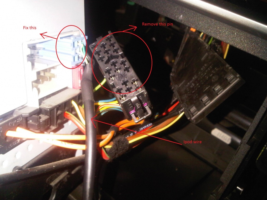

I fixed the wire. it was a piece of cake. didnt take more than 20 minutes.
The thing is:
-The yellow wire is for video output which we dont have in our cars.
-The blue pin fits after u remove the existing pin from the PCM which i dont know what the purpose of it or what it does.
-The only thing left is how to turn on AUX????!!!!!!
Any help is really appreaciated.
See attached pics. Hopefully these will help a bit as well as the write up in this link http://www.planet-9.com/reviews/elec...emoval-29.html
