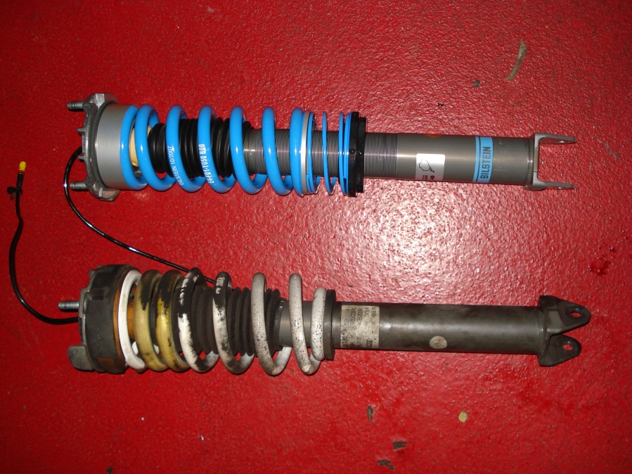

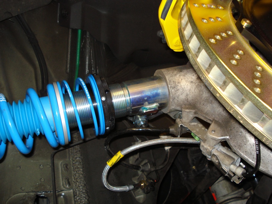

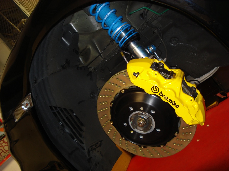

Old Jun 28, 2010 | 09:35 PM
yrralis1's Avatar
Joined: Jan 2008
Posts: 9,108
From: South Florida
Rep Power: 529
Here's a picture of my Turbo's Techart spring next to the Bilstein as well as a few from the installation taken by the guys who did the work and sent to me.
