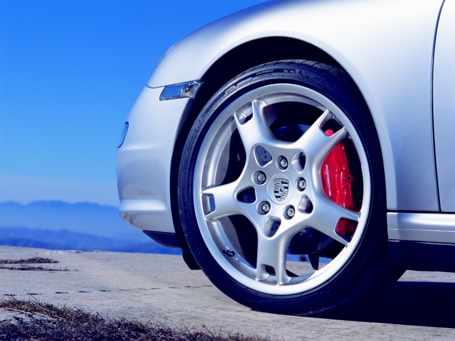

Okay...So I bought my 2006 C2S Coupe a couple of months ago with the Lobster wheels on it. I really wanted Turbo wheels but everything else about the car was exactly what I wanted so I took the plunge. How much difference is there (quality, weight, etc.) in the after-market Turbo replica offerings vs. OEM? Obviously the after-market offerings are less expensive...
Secondly, are there any fitment issues with putting '08-'09 Turbo wheels on an '06 C2S?

The OEM Turbo wheels are a light,forged 24 lb BBS wheel . Even though I think they look very Corvette ish they are still a great quality wheel . You will not get this with a replica . In fact --if a wheel center breaks from a cheap replica whatever you have saved to buy the wheel is lost.
It's an expensive car . If you don't want to spend the money keep the lobster wheels .At least they are safe cast wheels .

The OEM Porsche Turbo wheels are forged while the replica wheels are usually gravity cast wheels. For wheels that are made using the gravity cast processes, more material has to be added to increase structural rigidity.
I recommend going with a wheel setup that's at least low-pressure cast to keep the weight of the set down. It's not fun driving around on a heavy set of wheels.

Porsche rims are high quality and generally light. I would stay with the OEM period wheels, which define the image of the car for its time period. I like all PAG's rims, including the 997.1's which are easy to clean and are relatively light. I would keep them.

anything other than OEM wheels will not add to the resale value of the car. Stick with OEM. Turbo wheels are strictly for all-wheel drive models.

That's not true. I have OEM turbo wheels on my non 4 wheel drive Coupe...These came as a factory option with the car (about $2,500.00 on the MSRP window sticker).
