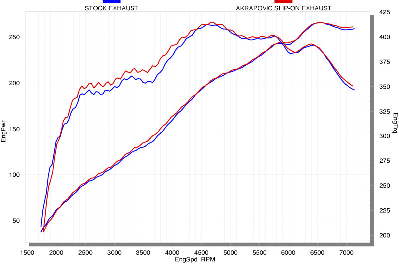

I'd like to mention an alternative made by Akrapovic. Their 997.2 system comes in two versions where one uses stock center muffler and the other a X-pipe, merging design. Akrapovic are usually made in Titanium, but these systems are said to be (or already are) avaliable in steel as well. Cheaper but heavier.
stock center muffler:
http://www.akrapovic.com/car-exhaust...on-8451983739/
X-pipe:
http://www.akrapovic.com/car-exhaust...on-410fa2fbd6/
By looking at the attached dyno graphs from their website, an interesting observation can be made about the effect of the X-pipe (wich is the only difference between the two systems).
Quite an increase in mid range power/tourqe!
The weight difference between the two systems gives how much lighter their X-pipe is vs stock, 10.8 lbs!
A mix with Akrapovic titanium X-pipe and Tubi mufflers would be a really lightweight option! Anyone dare to try?
X-pipe:

I was told the Akrapovic X-pipe alone is around 600 euros. The potential difference it makes can bee seen in the graphs.

I suspect a a maximum increase of 5Ib Ft torque increase will make very little difference to the bottom end!
964RS_NGT
600euro sounds very reasonable for a titanium pipe that save weight and add a few hp. But we don't know whether the diameter of the pipe will fit the original Cat and muffler. I'll email them to find out! Thanks!
964RS_NGT
