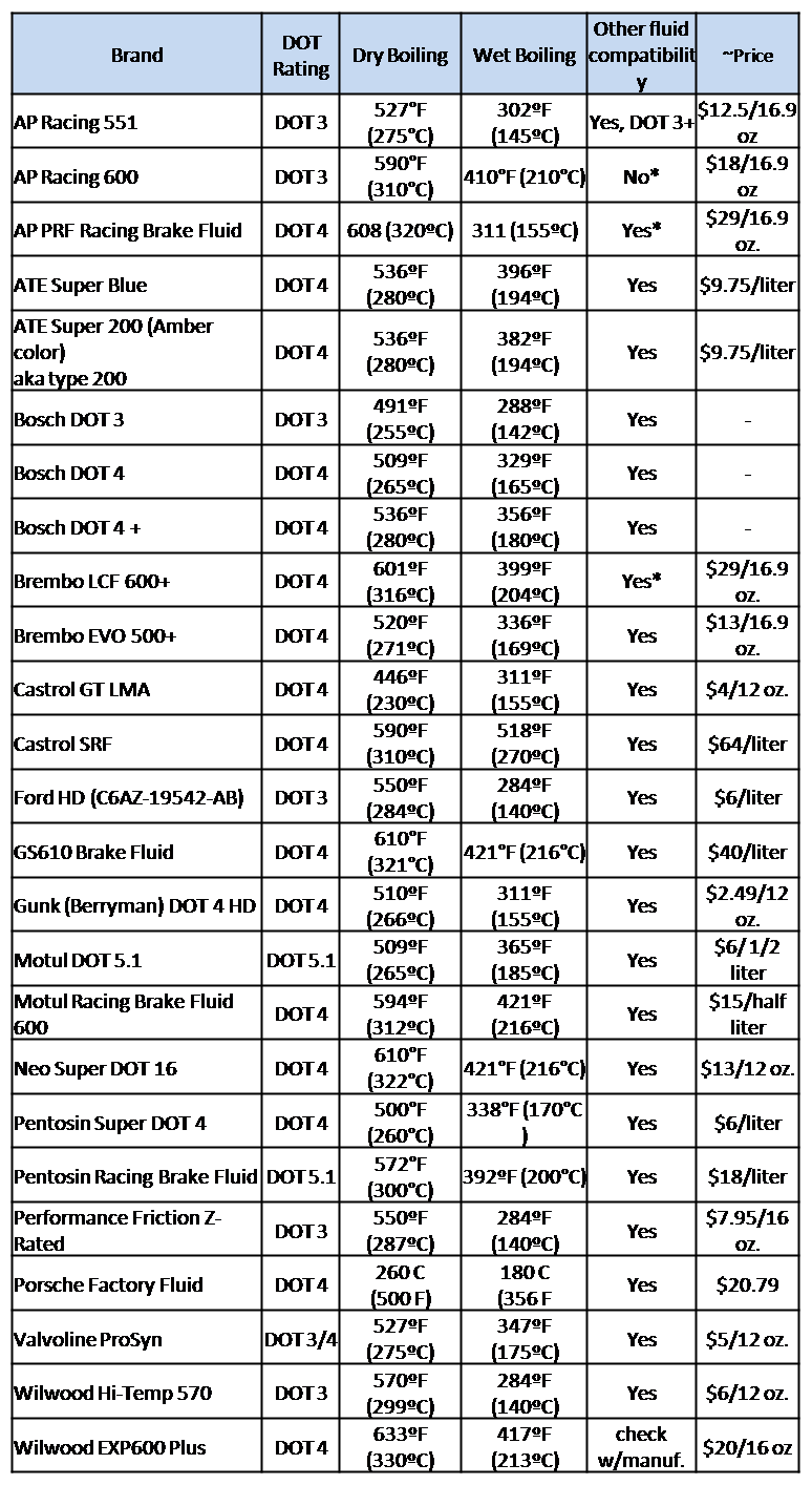

hate to say it, but i agree with northvan. damn.
for whomever is interested, here's some [old] data on brake fluids to help with any choices.
Name:	brake fluids.png
