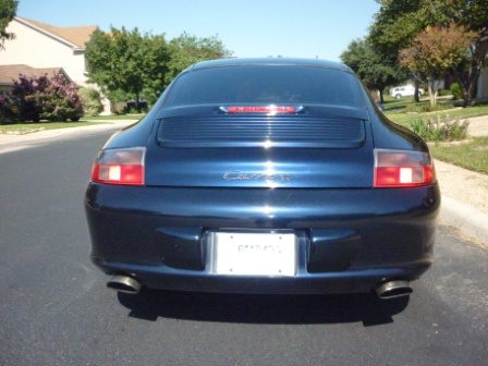

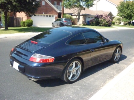

I live with it. Don't even notice it anymore (except for today after reading this post). No one else notices it either (see pics attached).
