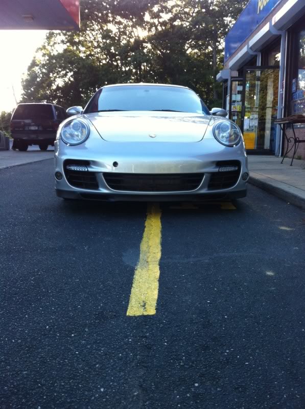

In case anyone else is worried about the electronics related to the LEDs, I also got them to work with no problems at all. I have had my turbo front end on for a few weeks now and I have not had one error message. I also have HID fogs, which my electronics shop also had to create the proper resistance for. To all who are fearful of taking this project on, rest assured it can be done. And it looks great! It's probably also worth mentioning that there is no pre-made wiring harness needed. I'm not sure if one even exists but all the various "modules" that dealers and shops have recommended to other 6speeders are completely unnecessary. My shop created their own harness and even kept my original wiring and plugs intact, in case I ever want to put my old bumper back. Everything was fabricated and installed in one day.
Well, your best bet is to find the bumper used from a Turbo owner who is doing a conversion him/herself. Between the bumper, paint and install you are probably looking at somewhere in the range of 3-4k I'm probably in about 4k myself, maybe slightly less. But it looks and works great!

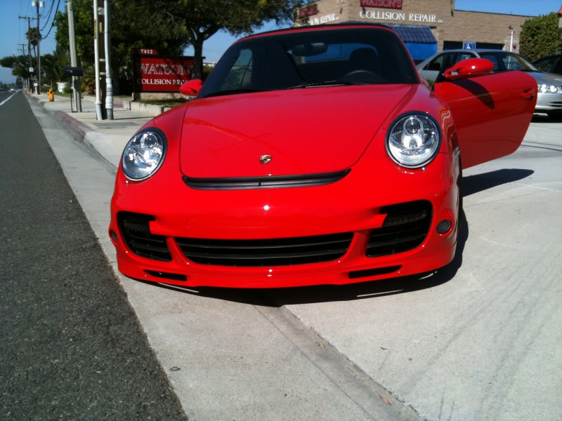

I just did the front bumper conversion. My only problem was the autobody shop that I was using couldnt figure out how to wire it up because they didnt have a good electrical guy. I got pretty lucky because the shop ended up having my car for the week and they felt bad so they didnt charge me to mount and paint the bumper
. All I need now is a new tow cap cover and my car is going out thursday to a local shop that builds race cars to do the wiring.
Here was my cost breakdown....
Turbo Front Bumper with fog lights and grilles - $400 (yes 400 lol )
LED DRLs from vivid - $1000
Paint and installation for bumper - $0
Wiring for lights - Approx $200...ill find out on Thursday

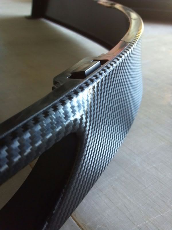

Front lower spoiler - $189 ( and I wrapped it in carbon fiber vinyl
. All I need now is a new tow cap cover and my car is going out thursday to a local shop that builds race cars to do the wiring. Here was my cost breakdown....
