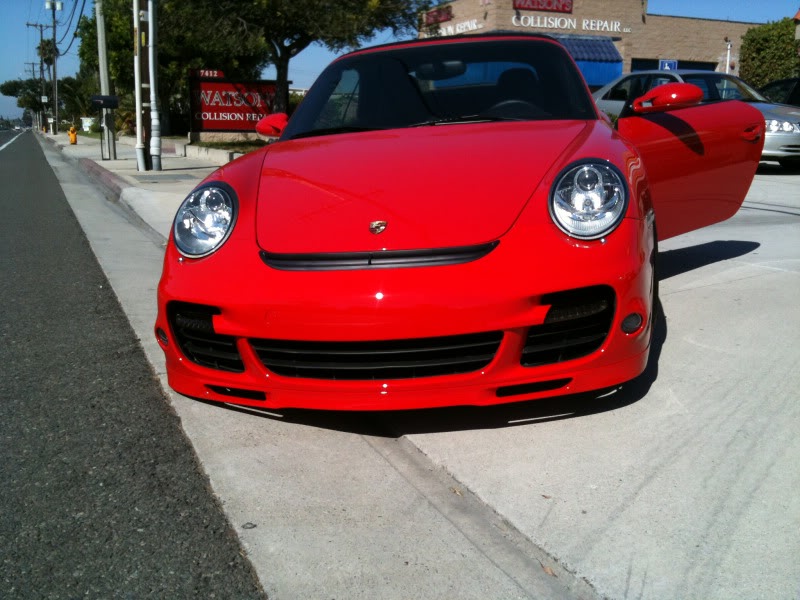

Here are some pics [IMG][/IMG]

That looks bad ***. I plan to do the same thing and will let you know if I find a solution. My electonics guy thought it could be done with resistors but I haven't tried it yet. Your setup looks great though!

Thanks for posting pics, it looks awesome. I really like it.

Really sweet. I've wondered why no one has done this conversion. From what I've heard from others, this is not a plug and play conversion even with the modules. THe wiring has to be modified and it is not straightforward. Anxious to hear if you get results, but that is what I know from someone else that did a basic 997.2 front end. I've not seen a turbo front bumper offered. Can you add where you got it and how much it was?

Thanks guys. Just like the other guys here who thought it was going to be a simple mod...turns out to be way more $$ than I thought. Here is the breakdown on parts / labor.
Bumper cover, fog lights, led lights, air vents (3 pcs), fender liners, GT 3 hood vent, blinker module, wiring harness and the latest part ( not in yet ) control module. came to a total of around $3300. For Carrera owners, you can still use your original air flow ducts, I ordered the turbo air ducts just incase but they seem to be smaller but luckily I was still able to use my original ones. That saved me $220!
The panel behind the center grill had to painted black, since I have no third radiator. Painted the bumper (orange peel to be oem) smoked the led blinkers, smoke my rear tails and my body shop charged my 1K flat.
The name of the body shop is Bell's Auto Body in huntington Beach they do all high-end cars, you name it they have done it, they are also porsche certified just incase you are wondering.
