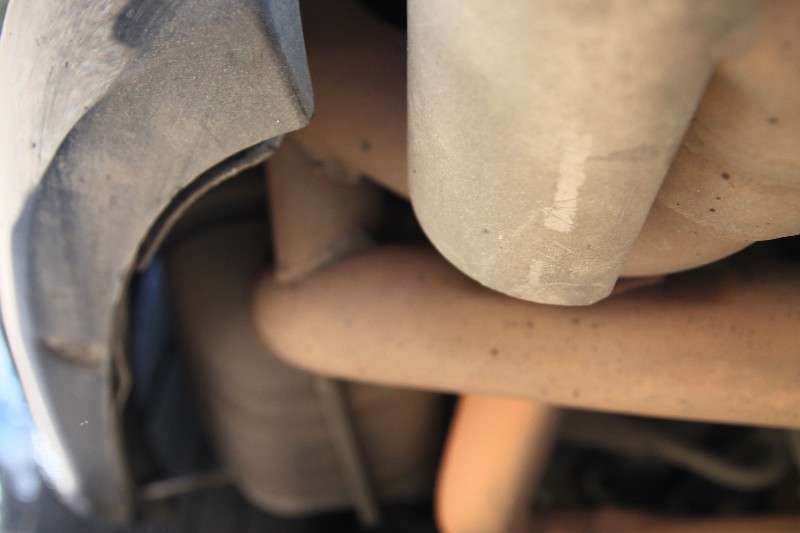

The modification shown in post #10 appears to be a piece of aluminized carbon steel tube welded to the muffler tubes. It makes for a really bad galvanic couple. Both the aluminum coating and iron in the carbon steel tube will be sacrificial to the 304.

Pic

Sorry the pic is a little blurry. The weld seems to be holding up just fine.

That's great the welds are holding up. However, keep an eye on the welds IF the the tubing and welds are not stainless. My partiail bypass was done with 1.75" stainless tubing and weld, mendral bent and fitted as close to the can as possible and nearly vertical as fitted in final position when installed. The pipe length per side is approx 7.5" due to the bends/cuts (but I've seen hacks using straight 3" - 4" length tubing and they sound great too). My exhast was then media blasted to finish up the mod. At 3150 RPM there is a note change at near or WOT. There is no drone (gundo hacks do not drone) and there is a slight improvment in throttle response. As far as HP increase - none as far as I'm concerned but no HP increase was expected. This is strictly an audible note change. I would not consider my exhaust pitch to be low but there is a medium to high note change at near or WOT. And that is what I was looking for. $300 is what the mod should cost though I wouldn't expect a basic muffler shop to media blast the cans as a finishing step - not really needed.
