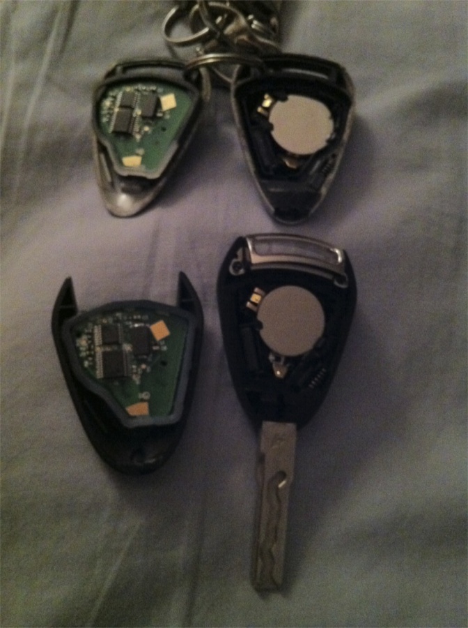

Is it possible to transfer the old circuit board to the new key head, thereby eliminating the need to have it programmed (and save $150)?
Old Dec 9, 2010 | 10:56 AM
pvanosta's Avatar
Joined: Jun 2006
Posts: 496
From: Amsterdam Area, Netherlands
Rep Power: 43
pvanosta is just really nicepvanosta is just really nicepvanosta is just really nicepvanosta is just really nicepvanosta is just really nice
It's not as simple as that.
The circuit board is an easy direct transfer.
BUT: there is also a small transponder in the keyfob housing (the size of a small tab of gum) and that is epoxied in solid (I could not get it out even with an exacto knife and applying considerable force).
Without the transponder and the circuitboard and the blade all in the same housing, the key does not work.
In case you're wondering: I did try several permutations of this before giving up and handing the whole kit over to my Indy and paying for the reprogramming.

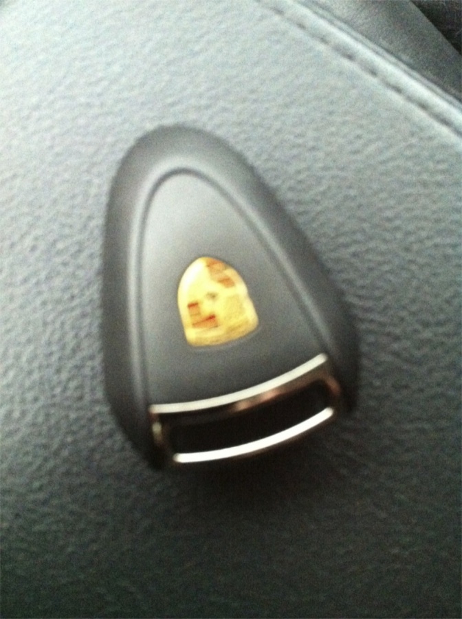

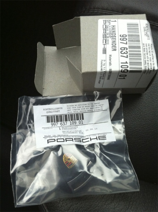

I ordered the new key head a couple of weeks ago and just now transferred the key blade from my old gray key head (top of photo) to the new GT3-style. Took all of 60 seconds for the blade transfer. I'm chickening out trying to get the transponder out and transfer the guts. Now the real 'key' to this is whether when I take it to the dealer they can program it successfully. Stay tuned...

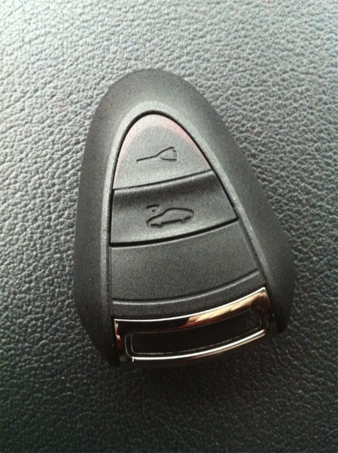

I ordered the new key head a couple of weeks ago and just now transferred the key blade from my old gray key head (top of photo) to the new GT3-style. Took all of 60 seconds for the blade transfer. Now the real 'key' to this is whether when I take it to the dealer they can program it successfully. Stay tuned...
Here's a couple of (poor quality) pics of the new key head prior to the transfer

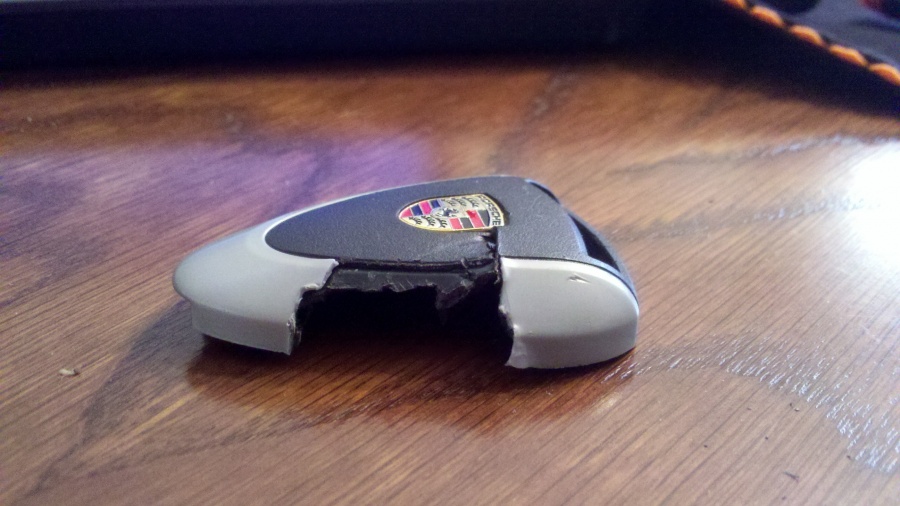

I upgraded my key as well for minimal cost. I removed the transponder (took about 2 hours) from the old key and placed it in the new key. As someone already mentioned, the transponder is glued, but it can be removed.
To remove mine I cut away all of the internals (i.e. battery connectors and plastic pieces around the battery). Try using both an exacto knife and needle nose pliers (as seen in this pic second from the top: http://www.lowes.com/pd_253677-16878...uantity_sold|1) These pliers are great for cutting hard plastic.
Use the pliers to cut away the plastic surrounding the transponder. Slowly and carefully work the transponder away from the key head.
Once the transponder was removed, I used the exacto knife to shave off the dried glue to allow it to fit into the new key head.
