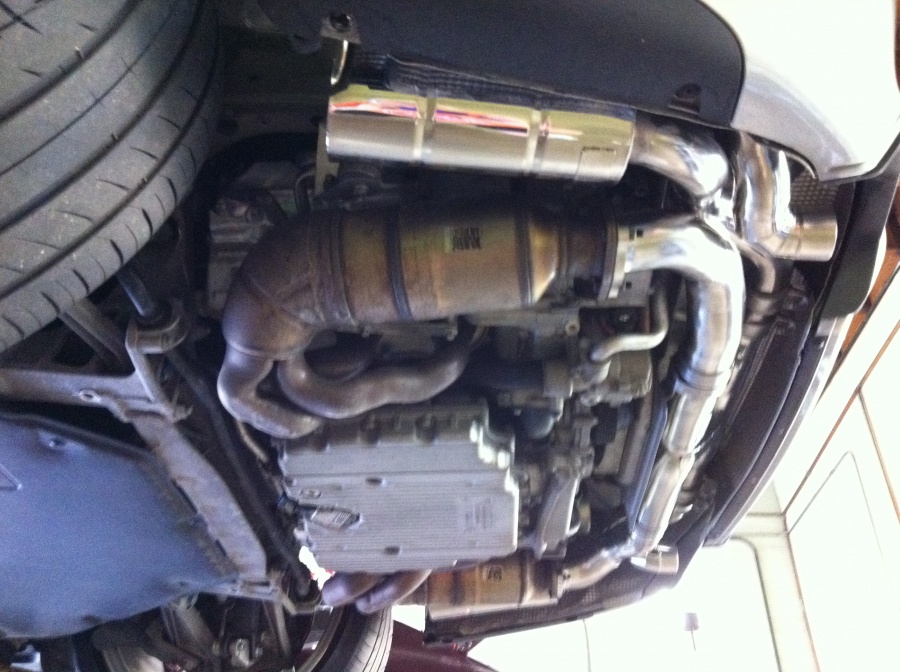

I have just installed the newest CAT-Back sport exhaust system from FVD (the FVD Street-Sport PDK Mufflers, part # BES 997 290 00S2) on my 2009 C4S and I have finally found the perfect combination of outstanding sound, quality, price, and performance enhancement for the newer generation 997.2 DFI cars. I realize that exhaust sound is very subjective and it is very difficult to really evaluate aftermarket exhaust systems from a video, but I have made a comprehensive 5-minute video of this new system which will hopefully give viewers a nice idea of what this new system sounds like. But first let me give you a quick history of the last year and a half and my search for the perfect exhaust system for the new 997.2 cars and my experiences with a couple other exhaust set-ups.
I took delivery of my 2009 C4S in Jan 2009 and right away realized that the OEM exhaust was WAY to quiet. PSE was not available yet on the new 997.2 and my objective was to get a PSE-like sound (deeper/louder yet sophisticated and refined with no drone) from an aftermarket CAT-back exhaust system and hopefully save some weight and get increased HP/TQ over OEM. The only available options in Jan 2009 were the Sharkwerks cross-over pipe, the AWE cross-over pipe, the Fabspeed side muffler by-pass pipes, and the Fabspeed X-pipe (merging flow). I chose the Fabspeed X-pipe because it sounded the best in it's video and offered the best performance increase (+13HP/+23TQ advertised) compared to the others. After I installed it I was disappointed - it was barely louder than OEM but it did give a slight boost of HP/TQ (seat of pants guess) but not quite as much as advertised.
My next step to getting the sound I wanted was to add the Fabspeed Dual-Tone side mufflers (Loud setting) which also advertised +11HP/+21TQ. Again, they sounded good in the Fabspeed video, but when I got them on the car in Nov 2009 I was again disappointed - barely louder than the X-pipe and not loud enough for my needs. To be fare to Fabspeed, their product was very well made and the sound was very sophisticated/European, but it was not as loud and aggressive as I was looking for.
Then in Jan 2010 I started looking at FVD products. I had put an FVD Sport Muffler (Export/Loud version) on my girlfriend's 2009 Boxster S and it sounded fantastic. That was the sound I was looking for (realize that the engine/exhaust layout on a Boxster is very different than a 997.2). I had previously not considered the European exhaust systems like FVD/Tubi/Cargraphics because they were not available in early 2009 and they were very expensive, they didn't promise much HP/TQ gains, and they did not have any good videos to evaluate the sound. In Feb 2010 I ended up getting the new FVD Sport Mufflers (Sound version) which advertised +15HP/+15TQ. It was unique compared to the other FVD/Tubi/Cargraphic offerings because it's design simply eliminated the entire Primary (center) muffler and used only the 2 FVD side mufflers, savings lots of weight. The quality of the FVD parts was top-notch. The sound was good but not what I was looking for - it was great above 3000RPM, very deep and throaty and refined, but below 3000, especially under load when accelerating, it was very raw and unrefined (in my viewpoint) and it was too loud (I can't believe I would be saying that!).

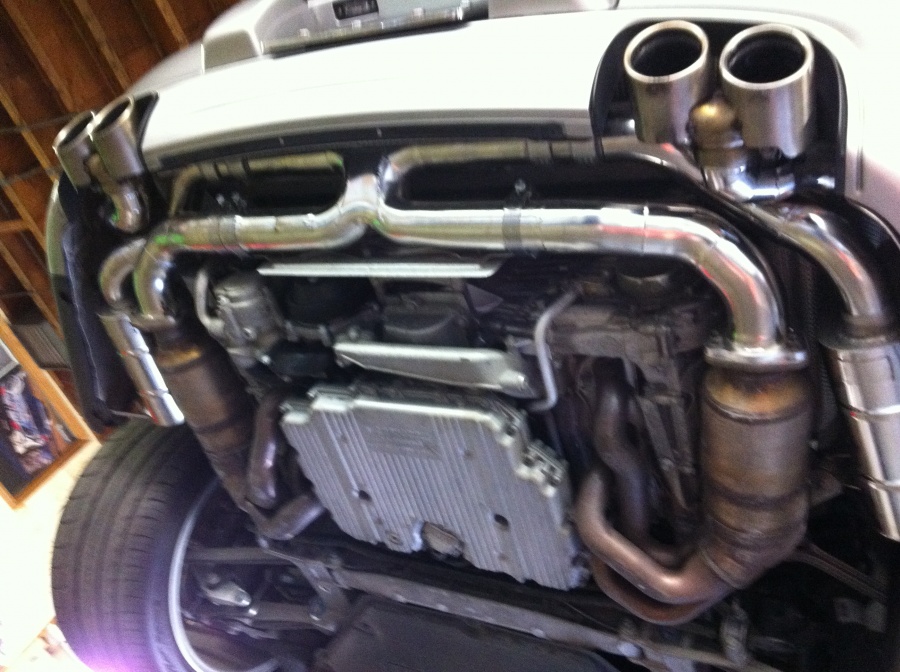

Finally, we come to my last (and final) set-up. This new FVD Street-Sport PDK system is perfect. It has 2 side mufflers (designed smaller than the other FVD Side Muffler offerings, similar in size to the Tubi and Fabspeed side mufflers) and has a new X-pipe design merging the exhaust flows (their previous X-pipe was a non-merging design). FVD advertises +18HP/+15TQ in this system and I believe it from my seat of the pants. The overall design is very much like the Fabspeed side mufflers and X-pipe. The workmanship/quality is great (I like FVD using T316 stainless steel were most others use T304). And the sound is just the way a Porsche should sound - I would say it is much like a GT3 RS but slightly deeper. It is refined around town when you want it to be and when you open it up, especially above 3000RPM, it sounds fantastic. There is absolutely no drone. And don't let the PDK part of the name fool you - it works just great on a 6-speed like mine too!! I would say this system sounds very much like the Tubi system but slightly more aggressive and deeper, costs less, and you get more HP/TQ. A bargain all around. And Rhonda at FVD in Florida is an absolute delight to work with - she really knows her stuff. Also, this FVD Cat-Back exhaust system is the only mod I have on the car and nothing else is contributing to the sound or performance gains. My Porsche dealer has no problems with warranty service.
I am posting my video below. I took it with a FLIP digital video camera and posted it to YouTube. If this link below doesn't work (it my be too long) then go to YouTube and search "FVD Street-Sport (PDK) Mufflers 2009 Porsche 997.2 C4S" If anyone has any questions send me a PM.
UPDATE: Well, my video doesn't seem to want to load up as an attachment/link to this post so you will have to go to YouTube to view it. I did manage to include a few pictures I took with my iPhone of the muffler system install.
