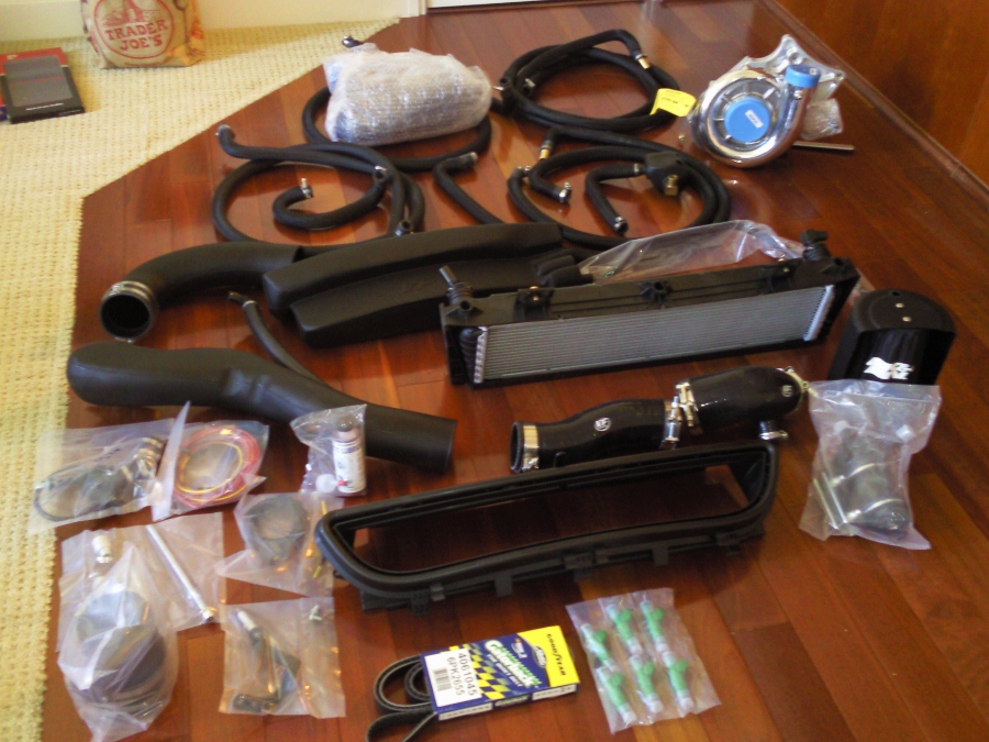

Originally Posted by 808c2s
Well, after a little over 1.5 months of anticipation, the VF-Engineering S/C Kit came! With the special deal from Vivid Racing, it was a no brainer for me. Dan from Vivid Racing was a pleasure to deal with and kept me abreast of my order. Very professional and courteous. Much appreciated.
Well here are some pictures of the updated Kit:
A few noticeable things at first glance:
1. The coolant lines have nylon-like sleeving over the rubber hoses.
2. Some of the hoses are already pre-bent, I guess to facilitate installation?
3. The K&N Filter has a plastic Heat Shield covering now, as you can see in the pix..nice touch
Attachment 141596
Attachment 141597
Attachment 141598
Now to go and read the instructions and find myself a lift .

Originally Posted by WTFitsCarter
Question... did it come with item 3F shown in this diagram? this is from the porsche manual on required parts for the center radiator retrofit.
Thanks!
Carter
NOT sure what 3F is referring to(front radiator weather-strip?)...but rest assured the kit IS complete to add the third radiator and Vivid racing,I am sure, will attest to it!
There was no money spared when they designed this kit...very well laid out and made of some of the best materials out there!
Stacy

Like justatoy said, the kit comes with everything that's needed to bolt it on. We did not have to order any additional stuff from Porsche.
Thanks!
Carter
