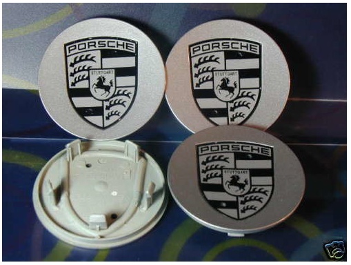

Has anyone swapped out their wheel center caps and can advise a simple way to do it?
I notice there are 5 clips on the back of the caps that hold it into the rim...how do you depress them so they'll pop out.
I'm sure it's not to difficult, I'd just prefer not scratching my caps up while trying to figure it out.
Image attached

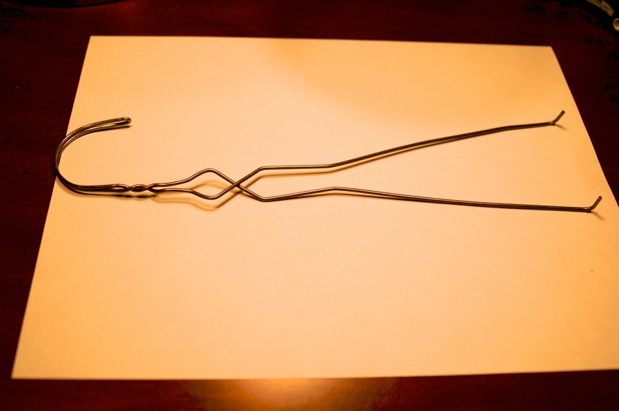

they are easy to remove from the wheels by using a wire coat hanger. you unwind the hanger and use the pointed ends, insert them in the 2 holes in the cap and gently pop out the caps.
the new ones go in a bit easier if you grease or vaseline them around the edges before popping them in.

Awesome suggestion, thanks!
Thanks for the great suggestion, KonaKai.
Swapping out the caps took less than 2 minutes. Not a scratch, very easy.
Here's the coat hanger tool:

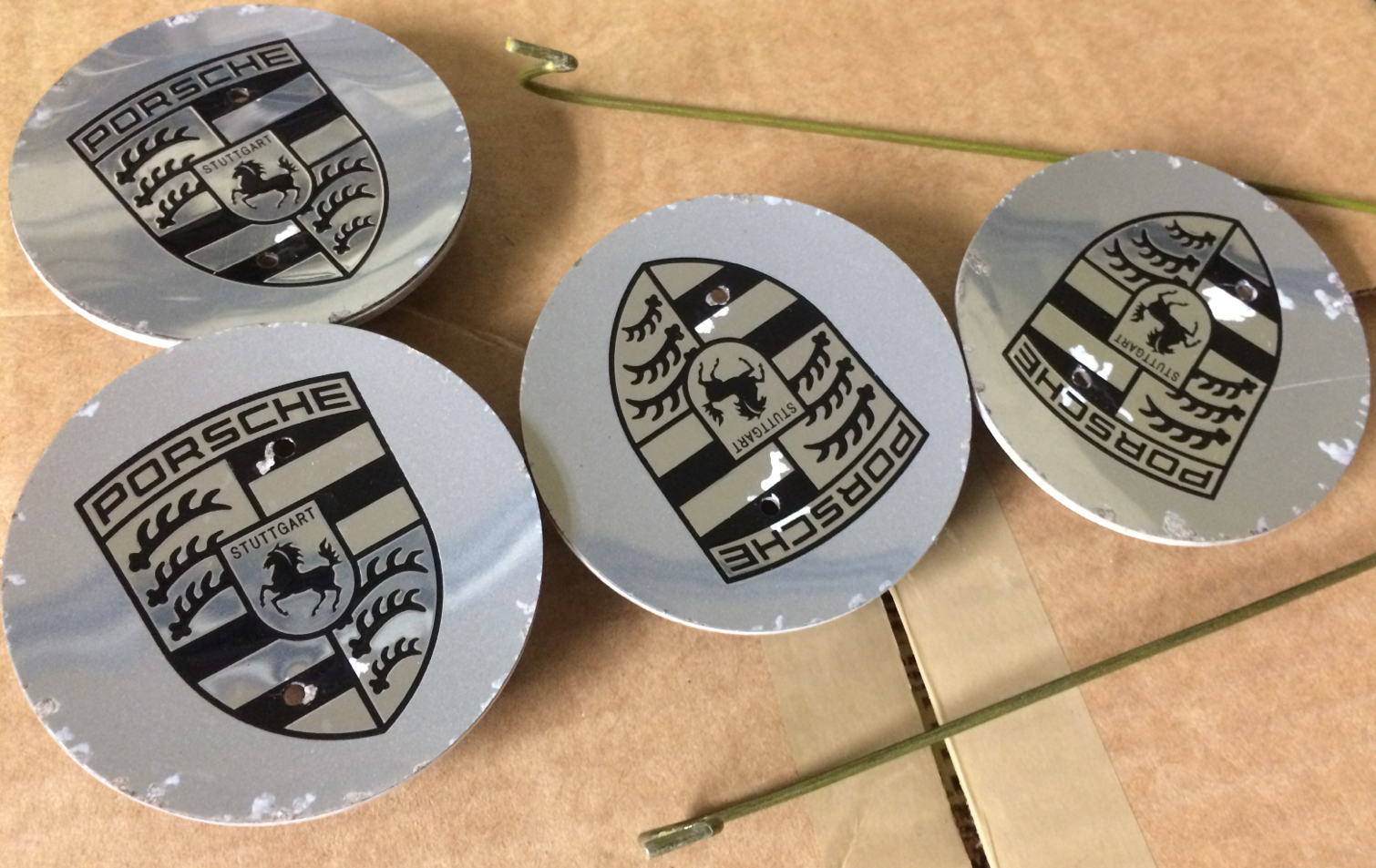

My centre wheel caps got pretty beaten up all these years, took delivery in 2006 August, summer and winter, one set of wheels, finally got them changed with the homemade hanger tool.
Thanks for all the tips here.
Name:	Screen Shot 2014-01-25 at 1.15.14 AM.png

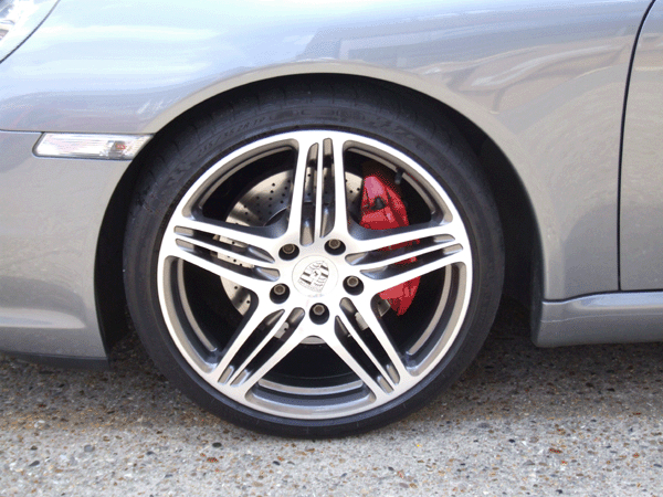

Good info thanks. I am planning to have mine replaced soon but I am trying to locate center caps that are blanks without any Porsche logo. Has anyone come across blank center caps to match 19" Turbo Wheels? Here is a pix of a wheel that I have on my car.
