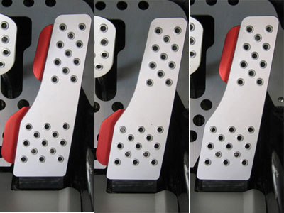

i've had these pedals for a while now.
they look and feel great !!
However, I've noticed, sometimes when i brake hard, my feet is still pushing part of the gas due to the toe extension.. luckily, i push the clutch in as well.
How can i just cut off the toe extension and leave the heel extension? (like the middle one in the pic)
tools needed?
anyone else with the similar problems..?

i ended up doing exactly that as with regular shoes I also did push upper extension. take it apart, saw off upper thing and keep lower one.
cool.
i'll get a metal saw on the way home.

I had the same problem too. I just removed the whole extension (and the optional lifter plate as well). The brake pedal is sufficiently larger than the OEM that I can H&T just fine without the extensions or added height. It took a couple of track days to get it dialed in though. Best,

Use a demel cutting tool, the piece that attaches the extensions has a few small tabs to cut to allow the piece to be removed. This is not reversible.
u r using oem pedals, northvan ?
