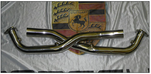

For Track Use only, I am thinking of doing cat-bypass on my car.
The FVD cat bypass seems like to have the best of both worlds in terms of what I have found.
Description on FVD site:
Catalytic Bypass pipe “X Torque” design made by M&M in Germany.
The "X torque" design in is a true X pipe design. It is open in the center to add backpressure for torque. Give's you 10-15 ft-lbs of torque in the mid range along with 10-15 hp in the higher rpms. Why settle for the traditional cross over cat design when you can add torque in the mid range where the 997's need it most!!
I figure a cross-over (NHP)style cat bypass may loss too much torque in the mid range and a X type which mix up exhaust from both banks (like Fabspeed?) may not gain as much on top end.
Does anyone have first hand experience with any of these cat-bypass pipes?
1st pic: FVD
2nd pic: Fabspeed
3rd pic: NHP

Performance wise, wouldn't the cat bypass yield more gains than the 200 cell high flow cat?

yeah youlll get more power with the bypass. get the x style cause no cats will give power and the x gives torque

What about the change in back pressure (loss in low end TQ) and the CELs?

Couldn't agree more. The shark knows his stuff. The bypass will lose low end power and touch however you will pick up a few ponies up top. Not worth it unless its a track car.
CEL will also drive you up the wall
I am worried about losing low end torque as well thus I think the X style bypass or the U style bypass may be a better idea.
CEL should be taken care of with a proper tune or a mini cat simulator.
To my surprise that no one who has done the cat bypass mod has replied probably most has gone with the high flow cat route.
