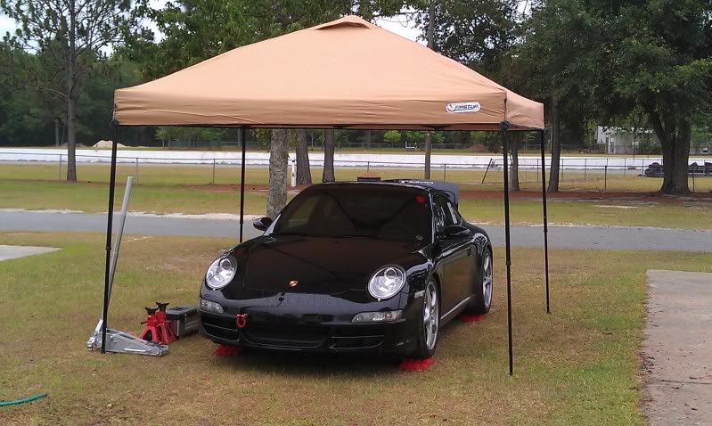

I've done a total of 8 HPDE days on my R888s and I rotate after each day and they still look like they could get another 4 days with ease, especially the fronts. I do run more negative camber though.
The R888s handle heat very well compared to other R compounds and the best heat range for them is 180-220 which in some cases can be tough to get to if you don't drive that hard but about 140 they start to get like glue. The first time out they will feel a little squirmy unless you shave them but after the 1st event that is gone.
They drive fine on the street but are noisy compared to a true street tire. I think they are a great bang for the buck but make sure you can dial in negative camber. This is a rule for most DOT track rubber. I run -2.5 fronts and -2.0 rear and with 36-38lbs hot are perfect for me.
I just got back from the Darkside DE event at Roebling and I was cutting 1:23s on them and I was not even hammering her deep into turn 1.
Even at this angle you can see the camber on the fronts:
