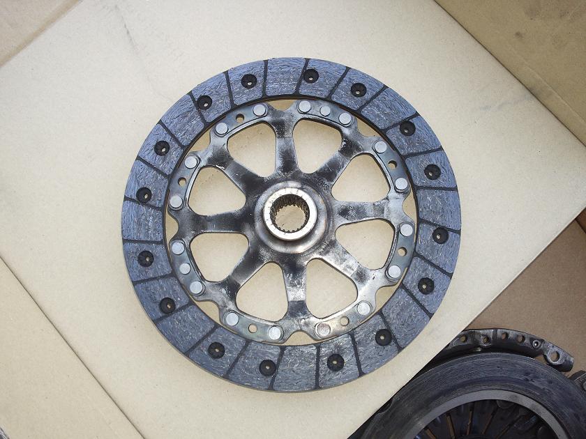

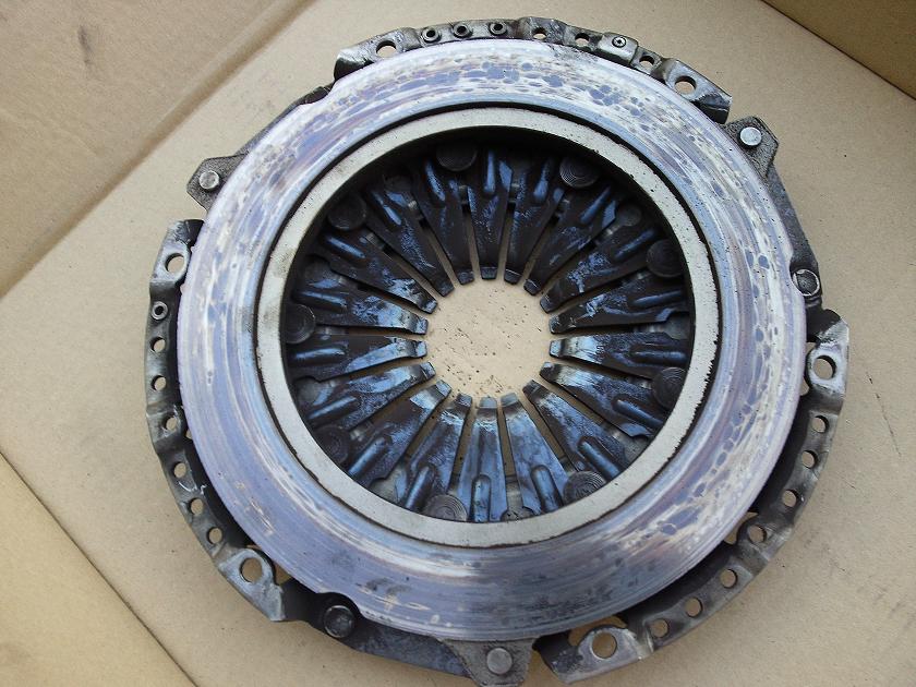

don't feel bad.
i had to replace mine couple of weeks ago with only 32k on the odo (i got it with 14k)
i know i don't abuse the clutch and i've been driving stick for 20years without problems.
BTW when i looked at my 'damaged' clutch, it didn't look too bad.
comments re pics? Thx

Originally Posted by crazycarlitos
don't feel bad.
The pressure plate looks like it got too hot.
I agree. It looks pretty toasty. It's surprising how quickly someone that doesn't know how to drive a manual can ruin it. Especially if they live in a hilly area.
don't feel bad.
heat soaked..........
