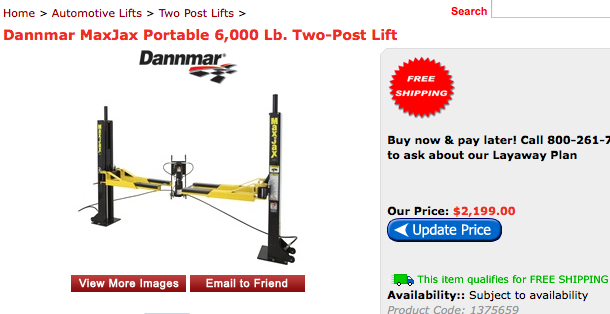

I started making my homemade ramps this morning and was a few feet short with the lumber! (off to home depot....)
I don't want to be a thread-jacker, but here is a neat P.S.:
BTW, here is the lift that a friend of mine just put in his garage. It has an MSRP of $2500, it ships for free, and he stores it in his closet. It DOES need to attach to a floor with 6 bolts, so I don't think it will work track-side. I've seen it for around $2K earlier in the year!
Note: I edited the pic to remove part of the phone number per forum rules!

That is bad ***!
