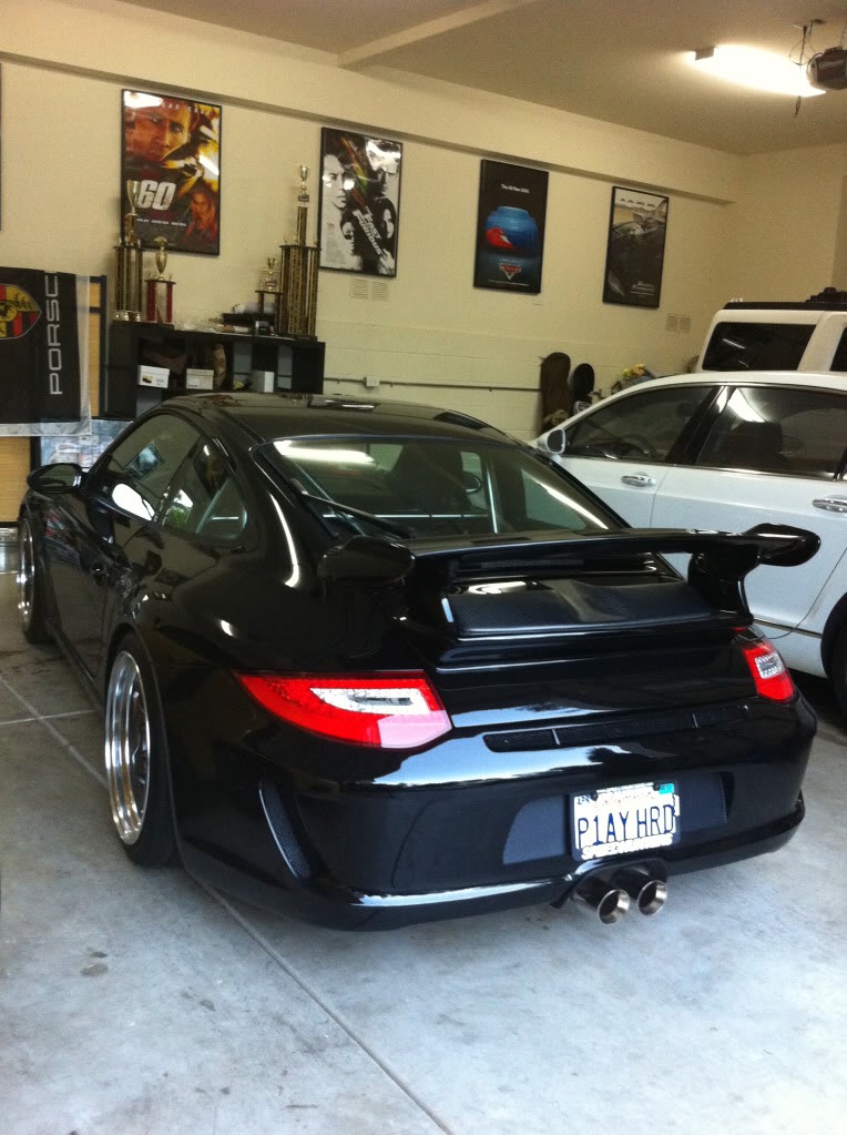

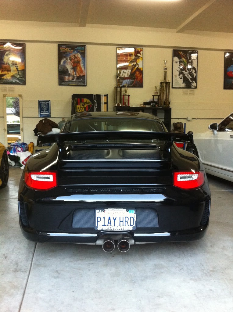

My thread is just about as detailed as it can get: https://www.6speedonline.com/forums/...wing-pics.html
I kept my 997.1 bumper. If you want to get the 997.2 bumper there are parts like you mentioned that are different and will need to be replaced. That is why I kept my old bumper. Since then I've changed my bumper to the Precision Porsche 997.2 GT3 rear that is compatible with the 997.1 internals.
